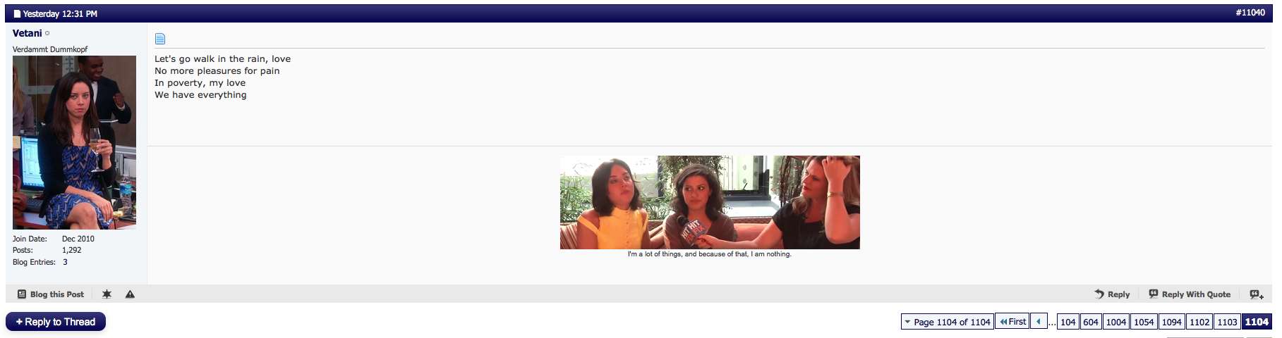

Screen shots of the two threads I was speaking about in my above post:
Screen shots taken at:
My subscribed threads notices showing last poster and time at the far right:
What I get when I go to last post in Accurately typed thread:
What I get when I go to last post in Line of Lyrics thread:
Again, I'm using Default skin.

Here is another example.
This same thing is now happening to me in the Just Neckbeard Things thread. I got a notification that someone had replied to my post there but it keeps taking me to page 1 of the thread (there are 2 pages, since I have my PPP set to 100).
My post was the last one on page 1, and the post (or posts, if there are any more than the one that quoted me) I can't see are the first ones on page 2.

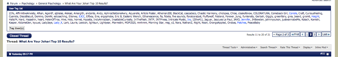

I just isolated a thread where this is happening and close it. I turned off every single mod one by one and none of them result in the most recent post showing up. It is the Drop and Give Me 20 Thread. You'll notice here:
Exercise Challenge
The last post was by EJCC Today (6/30), 10:07 AM
However if you go into the thread, you can't get that post to show up. It only lets you get to the third page. There is a fourth page which isn't visible as noted in the upper right hand corner. When you click on it, it keeps taking you to page 3.
Drop And Give Me 20! - Page 3
