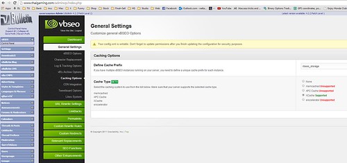

Actually uploading the files is a requirement for our modifications to function. The product is not going to work without the required files uploaded.
Additionally, I noticed that your XCache configuration is not working as intended. You need to edit /usr/local/php53/lib/php.ini and add this to the bottom:
xcache.var_size = 512M
xcache.var_ttl = 7200
then restart Apache.
Then, re-enable XCache in vBulletin's config.php file. For now, I have left XCache disabled in vBulletin's config.php file.

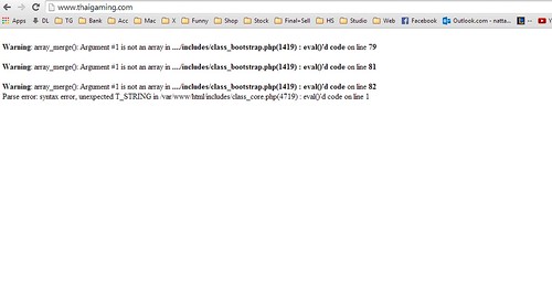

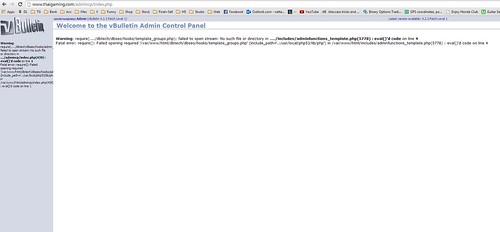

error relate to dbseo in cpadmin
and front page

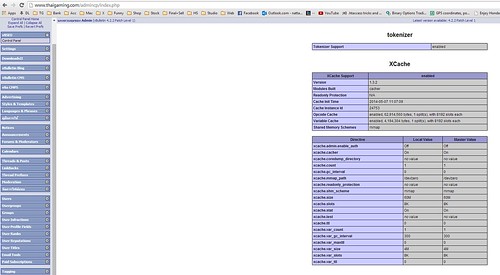

xcache status
This could mean that the XCache cached files do not work when loaded via vbAdvanced. Please try disabling file cache in XCache.
