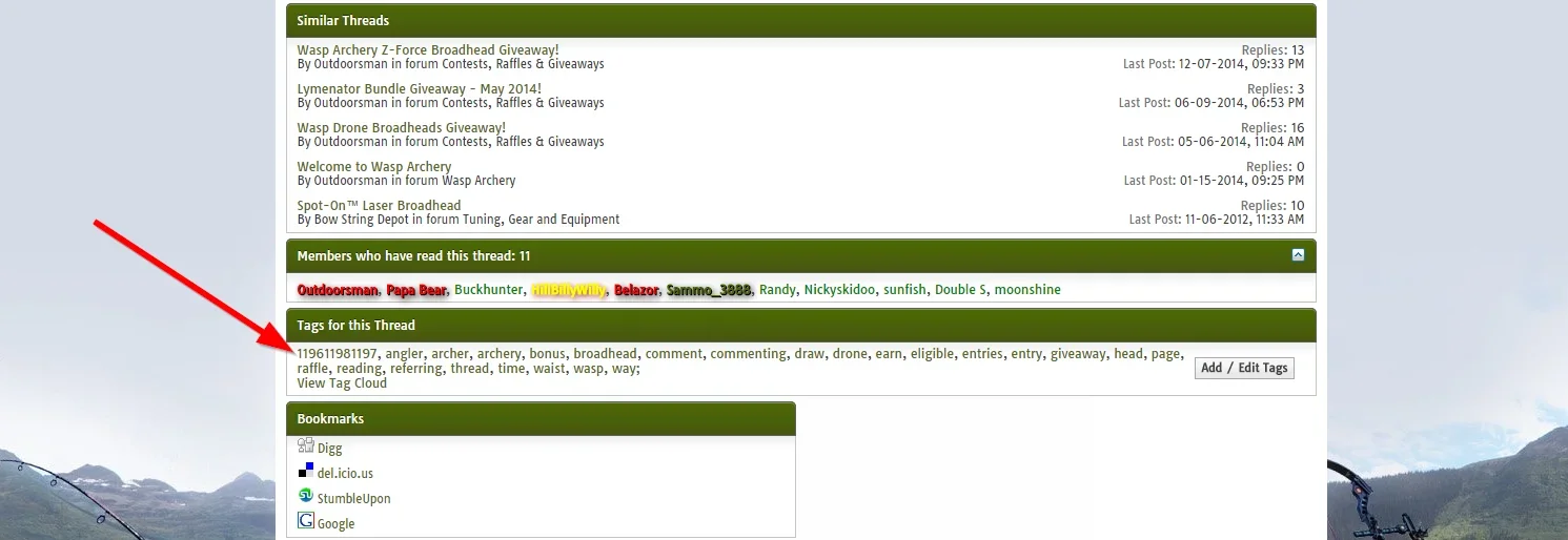

I do notice this strange tag however of numbers. I don't see these numbers anywhere. Would this be related to the thread links posted? 2014-12-21 19_10_43-Wasp Archery Drone Broadhead Giveaway - December 2014.webp
Possibly. If you have all the keywords you want to include added to the DBSEO CP, you can turn on the "Keyword Only" setting in the Tagging Settings in the DBSEO CP.
