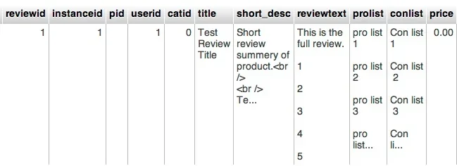

Are you using the full WYSIWYG editor? And if you look in the database at the table dbtech_review_reviews, in the field reviewtext, does it have the <br /> in there or normal line breaks?
It looks OK to me, but I posted a screenshot below so you could see it, just in case I'm looking at the wrong thing.

The db shouldn't have the <br /> in there, I'm not sure why it's adding it. If you go in and edit the image and remove the <br /> but leave the line breaks and save it, does it reinsert them?

Same question though, does it do the same when you modify the review and save it.
To fix it for now
Open dbtech/review/actions/view_review.php
Find
PHP:
$bbcode_parser        = new vB_BbCodeParser($vbulletin, fetch_tag_list());
after add
PHP:
$review_data['reviewtext']    = str_replace("<br />", "\n\r", $review_data['reviewtext']);
$review_data['short_desc']    = str_replace("<br />", "\n\r", $review_data['short_desc']);
