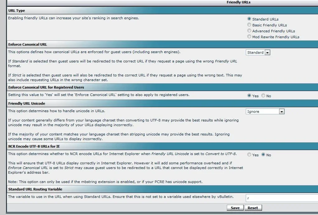

Have you turned off the vBulletin Friendly URLs and made sure the canonical URL enforcement is also turned off?
This was a paid installation last July and I haven't changed anything in either AdminCP or dbSEO CP. Please see attached screen cap, looks like Friendly URLs is off, but canonical enforcement is on?
ok, changed those settings, and then enabled dbSEO. Same issue still occurring. Disabled dbSEO, problem went away.
