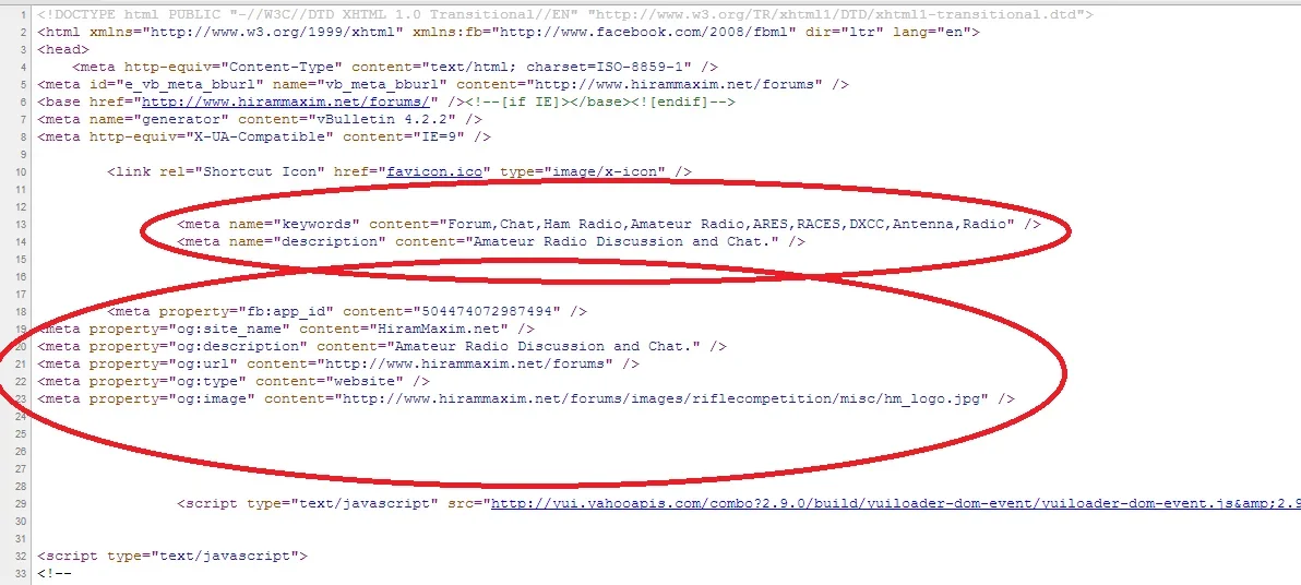

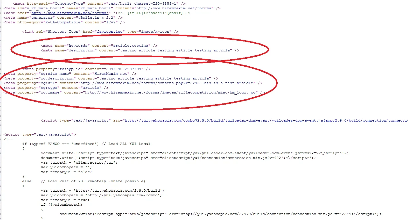

There was an issue on facebook opengraph once the forum ads is installed on the article page. When the forum ads is enabled the facebook opengraphs and the meta description and meta keywords will set to default or global value, If the forum ads is disabled then it will work correctly. Please check this screenshot attached
This is the source code view on the article page when forum ads is enabled
This is the source code view on the article page when forum ads is disbled
The issue are when sharing the article on facebook it will not get the correct title, description and the image. Also it will affect the SEO. I updated it to the latest version but still its not working right.
