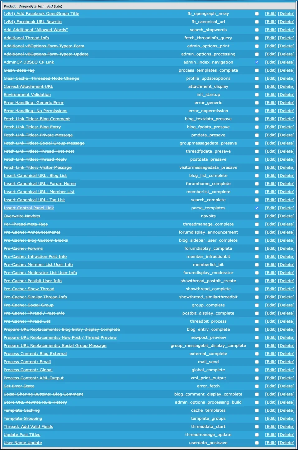

Here's a screenshot of my vBulletin Plugin Manager settings for DBSEO:
8463
Please turn all of these plugins back on, otherwise the mod will not function.
