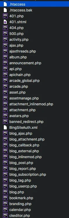

8441
The .htaccess file should be in the same location as these other files (some of which you won't have as they are from other add-ons).

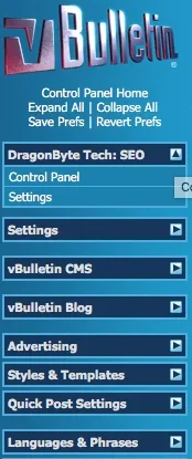

As you can see in this screenshot...I currently have the DBSEO control panel & settings showing up in the vBulletin Admin CP:
8442
In that case I'll need an FTP and AdminCP account to look into this further.
