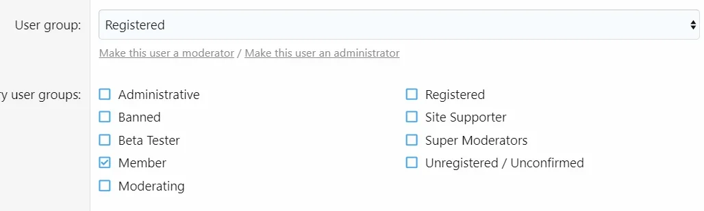

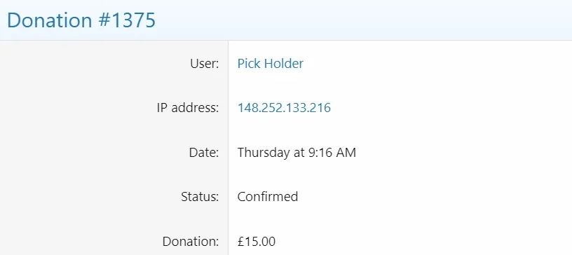

Continues to happen... three in the last week where donations have been made, and they are confirmed and successful, but days/weeks/months later later their status reverts to "registered" (the donation process "upgrades" them to "Site Supporter" for a year).
Entry in xf_user_change_temp :

Donation status :
User :
They have lost "site Supporter" as the secondary group, which "upgrades" them....
