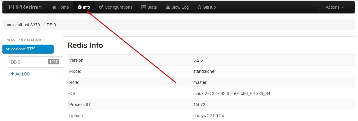

When i click "Info" on top navigation, there is an info page, containing information about :
  • Keyspace Hits
  • Keyspace Misses
  • Expired Keys
Maybe that is the stats?
And I think there is no max memory setting of redis (such as in APC / Xcache), i could be wrong anyway. This is my first time using redis.
