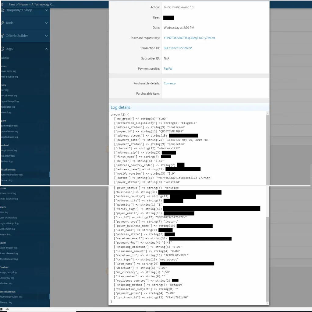

I found this in the log (I've blacked out any personal identifying info):
Is that helpful?
Does event ID 10 exist in the system?
It doesn't.

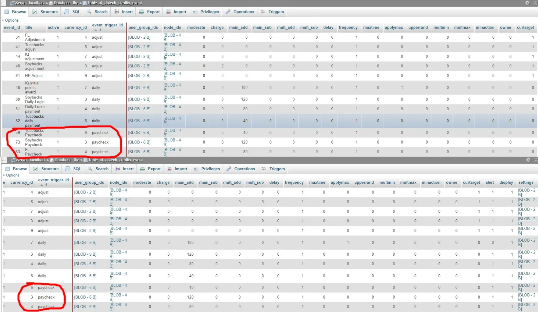

But that could be because in my efforts to troubleshoot this issue I deleted and then remade the currency and all of the associated events. For this remade currency there is an event for purchase in the table:
xf_dbtech_credits_event
The table entry for that event only has: active =1, frequency =1, alert =1, display =1, and this in the settings:
{"purchase_description":"Purchase 1,610 Heaven Points.","purchase_cost":5,"purchase_amount":1610,"payment_profile_ids":[1]}
All other settings are =0
I remade this currency in the same way as the original. I only remade it because doing that fixed a couple of other errors I was having for other currencies shrug.
Then yes, any purchases that were still being processed under the old event would fail with no way to recover them. You would need to process them manually by adjusting the recipient's credits.

Here's a screencap of the table (try not to pay too much attention to the names, it's meme-ish :) ) :
Usergroup ID is right now only admin and another group I'm using for testing. Node ID's says: [-1].
In the final column, settings, the only thing listed where it says BLOB 2 is "[]" without the quotes.

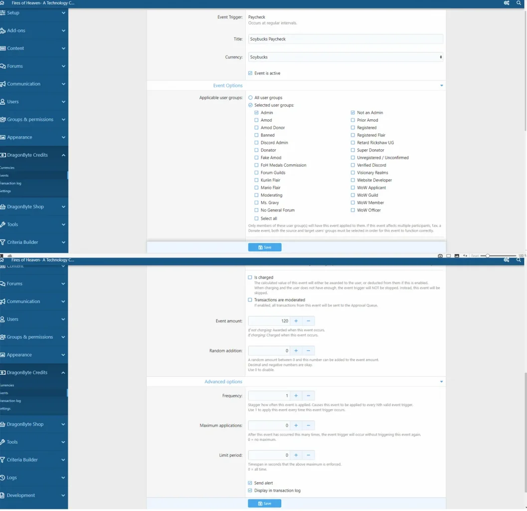

I need to see a screenshot of the UI, not the database :)
Right. Try this:paycheck screens2.jpg
They are all set up the same, the only thing that changes is the amount, the currency field to correspond with the currency, and the title field.
EDIT: It seems like the paycheck event is only firing for the currency with the lowest currency ID number, from testing it out. Dunno if that helps.
