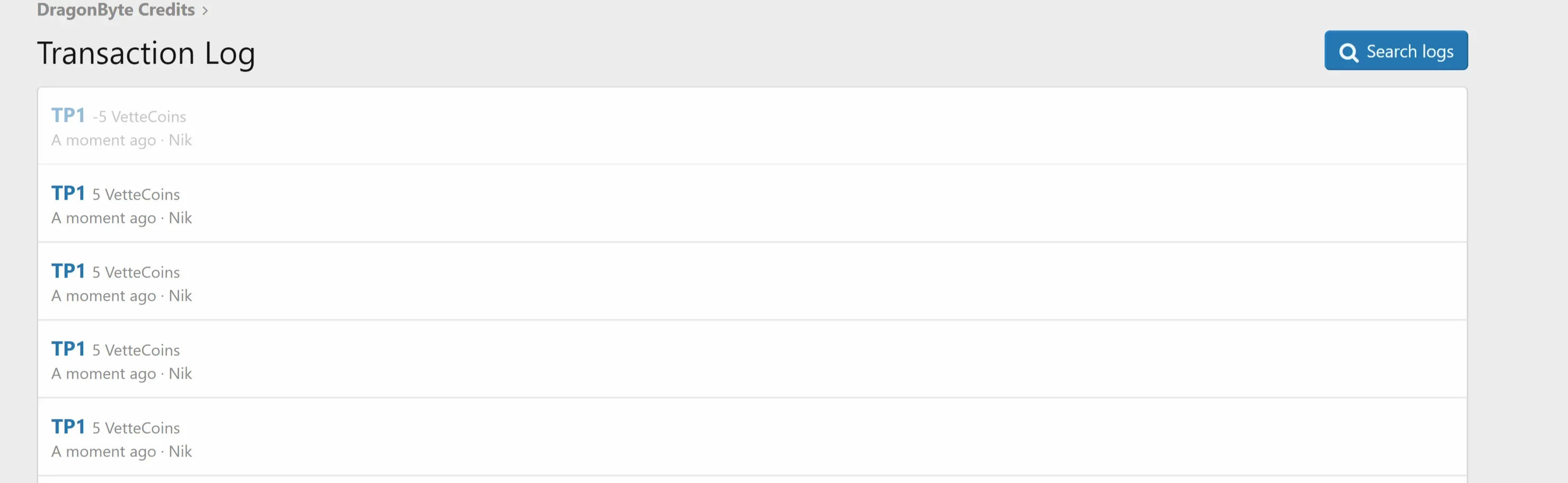

This was a test using max = 3, I did one edit and I'm showing 5 credits on the front end which doesn't match up the transaction log below at all.
See attached. Easy to recreate, basically put a low ceiling, go beyond it, edit any previous post and you'll see totals going down. Not sure if other event types that allow for a ceiling are affected.
The transaction log in the AdminCP does not make any distinctions about whether a transaction was skipped, which is the issue you're seeing in the transaction log.
The problem is that the system has no way of knowing whether a successful transaction has been applied prior to negating it. That's one of the big design issues still left in this mod (you would have hated the vB version with a passion 😝).
