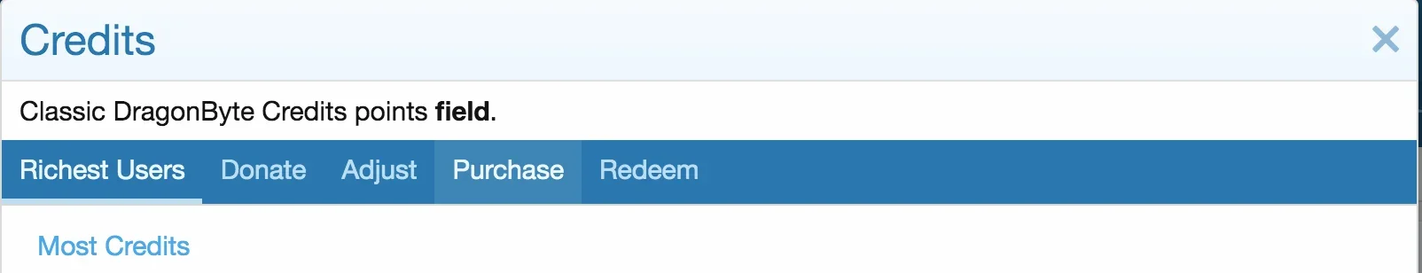

1. Is it possible to show the currency description on this page? Currently it only shows the name of the currency. I actually can't see anywhere that the description is displayed.
2. If it's not possible to use the description here, can I add arbitrary HTML to this page under the currency name?
3. Can I change the order of the two tabs, "Richest Users" and "Purchase" so that "Purchase is displayed first by default?
4. If it's not possible to change tab order, is there any way I can link directly to a purchase form, or embed currency purchase in another page or post?
Not at this time, as it's only designed to be a small popup at this time. I could look into showing the description above the tabs, though.
That is not supported at this time because the Purchase tab only shows up when a valid Purchase event is found.
That would be excellent, thanks! The description can fit into the popup easily, but also this has it's own page in addition to the popup.
Can't this be conditional? If purchase event exists, show it in this order, else do not. I tried editing the template to move the tab order, but did not have any luck getting it to work.
In my opinion, "Richest Users" is not very useful to always show whenever a currency link is followed. Most users will be more interested in their own credits and what they can do with them, including the ability to purchase more.
This is because you would also need to change the order of the <li> tags under the <ul class="tabPanes"> class.
