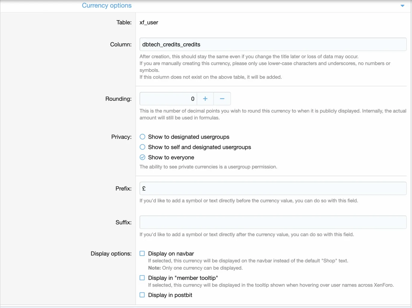

Question How to connect the credits with shops
In the Shop's Currency settings, click the currency then choose the corresponding Credits currency in the "Integrated currency" drop-down. This will disable editing of anything inside the "Currency options" option group for that currency, as those values will be overwritten on save by the values from the Credits currency.
In other words, if you change any of those options in DB Credits, you should edit and save the currency in Shop as well to ensure the settings have synced.
Okay, going to take some time getting used to it but I'll get there. Thank you!
What one would I need to edit to make changes? Is there an order? and to confirm, I would need to make the changes in both credits?
Only these settings are synced:
Those settings are the same across both Credits and Shop.
1. Edit the Credits currency and make changes
2. Edit the corresponding Shop currency and save without any changes
That should ensure that any changes to prefix/suffix/etc are synced from Credits to Shop :)
