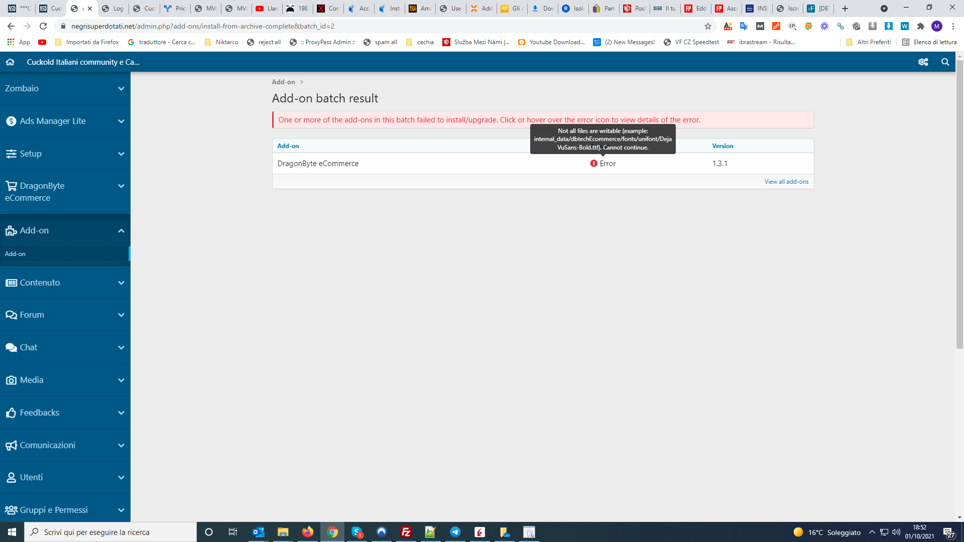

I uploaded the 2.3.5
but into admin panel, keep asking me to install 1.3.1.,
probably cause its partially installed
so I cannot install the 2.3.5
how to remove 1.3.1 manually???
has been partially installed when I had the xf2.1 , so I cannot unistall it now
how to do it?

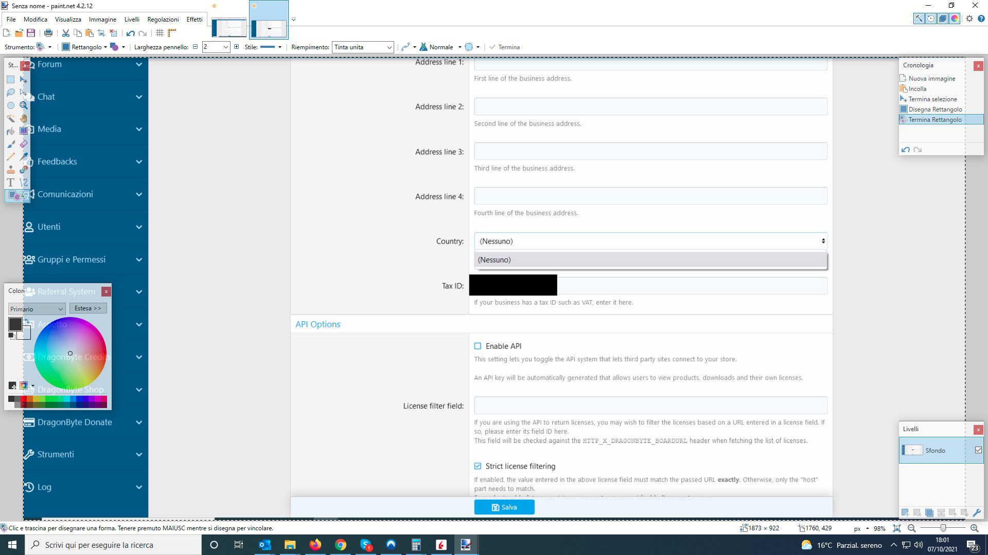

looks like is installed, but issue is the same, I cannot add products, categories, or my company country
I see this
"Please create at least one country before continuing."
I see this
Once you've upgraded to 2.4.0, please go to admin.php?options/groups/dbtechEcommerce/ and fill out the "CountryLayer API Key" setting. Once that's done, if you refresh the page, you should be able to fill out the country information in the Invoice Options.
