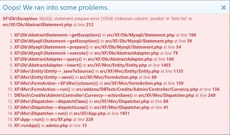

Ok so I uninstalled v5.1.0rc2 and then installed 5.0.3 then upgraded to v5.1.0rc2 again. I can now adjust currency again. But now when I try to add a new currency I get this error.

EDIT: After looking through the setup.php file I found...
PHP:
$tables['xf_dbtech_credits_currency'] = function (Create $table)
            $table->addColumn('currency_id', 'int')->autoIncrement();
            $table->addColumn('title', 'varchar', 255)->setDefault('');
            $table->addColumn('description', 'blob')->nullable(true);
            $table->addColumn('active', 'tinyint')->setDefault(1);
            $table->addColumn('display_order', 'int')->setDefault(0);
            $table->addColumn('table', 'varchar', 255)->setDefault('');
            $table->addColumn('use_table_prefix', 'tinyint')->setDefault(1);
            $table->addColumn('column', 'varchar', 255)->setDefault('');
            $table->addColumn('use_user_id', 'tinyint')->setDefault(1);
            $table->addColumn('user_id_column', 'varchar', 255)->setDefault('user_id');
            $table->addColumn('decimals', 'tinyint', 2)->setDefault(0);
            $table->addColumn('privacy', 'tinyint')->setDefault(0);
            $table->addColumn('blacklist', 'tinyint')->setDefault(0);
            $table->addColumn('prefix', 'varchar', 50)->setDefault('');
            $table->addColumn('suffix', 'varchar', 50)->setDefault('');
            $table->addColumn('negative', 'tinyint')->setDefault(0);
            $table->addColumn('maxtime', 'int')->setDefault(0);
            $table->addColumn('earnmax', 'double')->setDefault(0);
            $table->addColumn('value', 'double')->unsigned(false)->setDefault(1);
            $table->addColumn('inbound', 'tinyint')->setDefault(1);
            $table->addColumn('outbound', 'tinyint')->setDefault(1);
            $table->addColumn('is_display_currency', 'tinyint')->setDefault(0);
            $table->addColumn('sidebar', 'tinyint')->setDefault(1);
            $table->addColumn('postbit', 'tinyint')->setDefault(1);
            $table->addColumn('member_dropdown', 'tinyint')->setDefault(0);
I checked my database and saw that "postbit" table was not in "xf_dbtech_credits_currency". I manually added it via phpMyAdmin and it is now allowing me to add currencies.
I'm not sure if the installation is bugged or If I caused an anomaly while upgrading (un/re)installing and upgrading lol
Does the Adjust event work now?
Yes, that started working along with editing credit values in user admincp after the uninstall of rc and installing stable and then upgrading again to latest rc.
After that I just had to add the postbit table to database to be able to add new currencies in admincp.

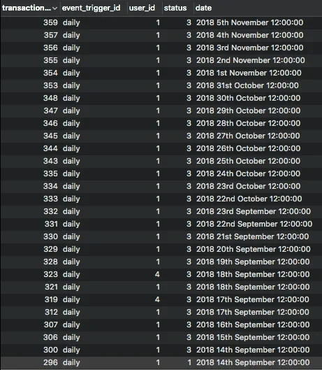

In order to test this event I'll have to manually adjust the existing "last daily credits" time stamp then trick the forum into thinking the time is actually X days ago, I'll report back with my testing methodology and results.
Update: Actually, I think I might be able to say this is working even without any trickery. I noticed I'd already set up my event with a frequency of 30, and this is the result in the database:
The highlighted row on the 14th of September is the last successful trigger, so it's been 24 days of "missed" triggers since then (not including today).
My question is: If the "Frequency" setting is set to 25, and it's skipped 24 transactions (14th Sept - 4th Nov inclusive), would you expect it to trigger today (on the 25th valid event trigger) or tomorrow (on the 26th valid event trigger)?
My guess is you'd expect it to trigger today. In the current RC2 version, the logic is actually bugged by two whole steps (it checks if the skipped transactions is less than or equal to the frequency, meaning it would trigger successfully on the 27th trigger).
Let me know your thoughts so I can ensure I get it right for RC3 :)
