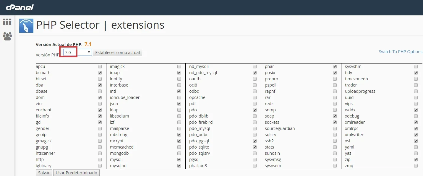

Thanks, one last question. It is normal with php5.6 if it runs smoothly and fails with php7.1? Changing the php version does work.
Thank you
I couldn't say, there may be a bug in your particular version of PHP 7.1. Does it work in 7.0?
Seems like something may have changed with PHP's memory management in 7.1 then. I would recommend sticking with 7.0.
