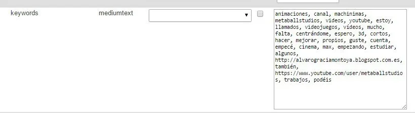

since last update I see a column in the database "keywords" is filled with words separated by commas, and is negatively influencing seo, since they are not descriptive or key word and which in themselves have no content.
As I can stop this? I do not want keywords .. please.

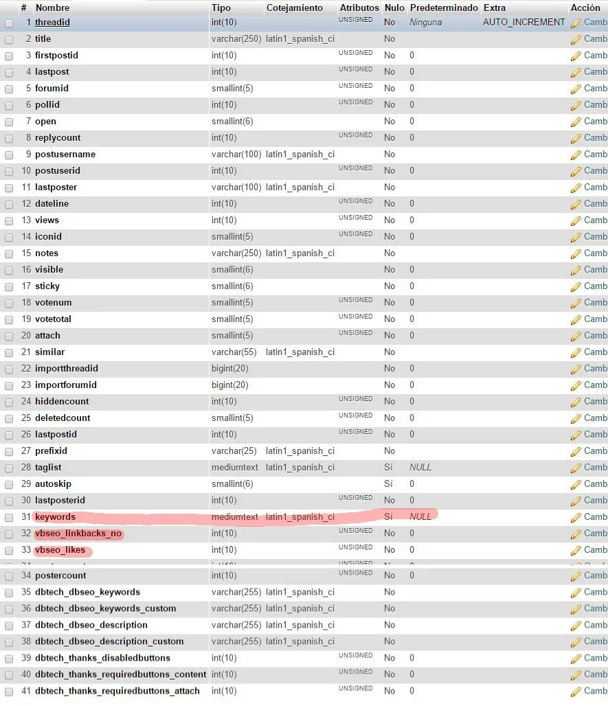

Hello, in the table thread.
I also just realized that I have two columns within thread to erase yesterday and are now again, vbseo_linkbacks_no and vbseo_likes such as this ?, are created by themselves again? thanks, I attached a picture to give me better understand and red border.

The keywords column in the thread table is unrelated to DBSEO. All DBSEO columns are prefixed with dbtech_dbseo_ when we modify vBulletin's DB tables.
