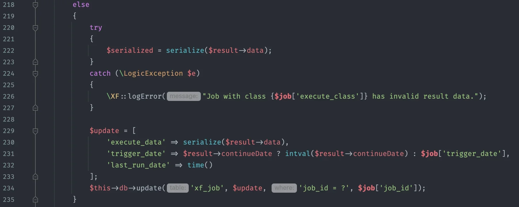

It should look like this:
Then wait for the error to be replicated. You should have a new error message directly above the LogicException error in your server error log that will tell us which job class is causing the error.

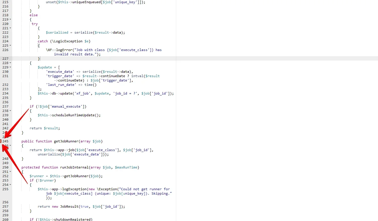

i also see this
    ParseError: syntax error, unexpected 'public' (T_PUBLIC) src/XF/Job/Manager.php:245

I'm assuming you resolved this? The code wasn't copied correctly.
