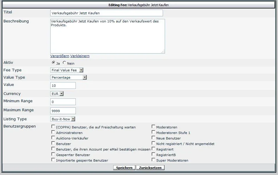

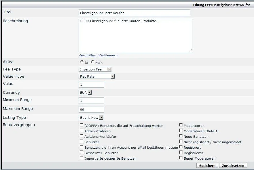

What did I set wrong? Here are the screenshots of the both fees. One insertion-fee and one final value fee.

The settings on your fees look great, but just remember that you need a fee for each type of listing you are doing, so one for auction, one for Buy-it-Now, etc.

I have now deleted one of the fees that I set up. Before there were 2 fees for "Buy-It-Now" - one Insertion Fee with Flat Rate and one extra Fee in Percentage for the Final Value. Is it possible that 2 fees not work together? Because now it works with just one fee :)
Hmm... or perhaps is it not possible to make a final value-fee for buy-it-now listings?

Regarding the fees, the final value fee will only work once you have the final sail price at the sale. That is done so that a user won't be charged unless they sell. If you want to charge regardless of whether they sell or not, then you need the insertion fee with a percentage.

Yes - but I think the final value fee and the percentage-fee do not work both together - could that be the problem?
I'll look into if there is an issue, but they were designed to work together. The PM I'll work on. :)
Well, after a lot of digging around I think I found the issue. I've got this fixed and working on my dev version now. I'll put a patch out next week that will resolve this issue. :)
