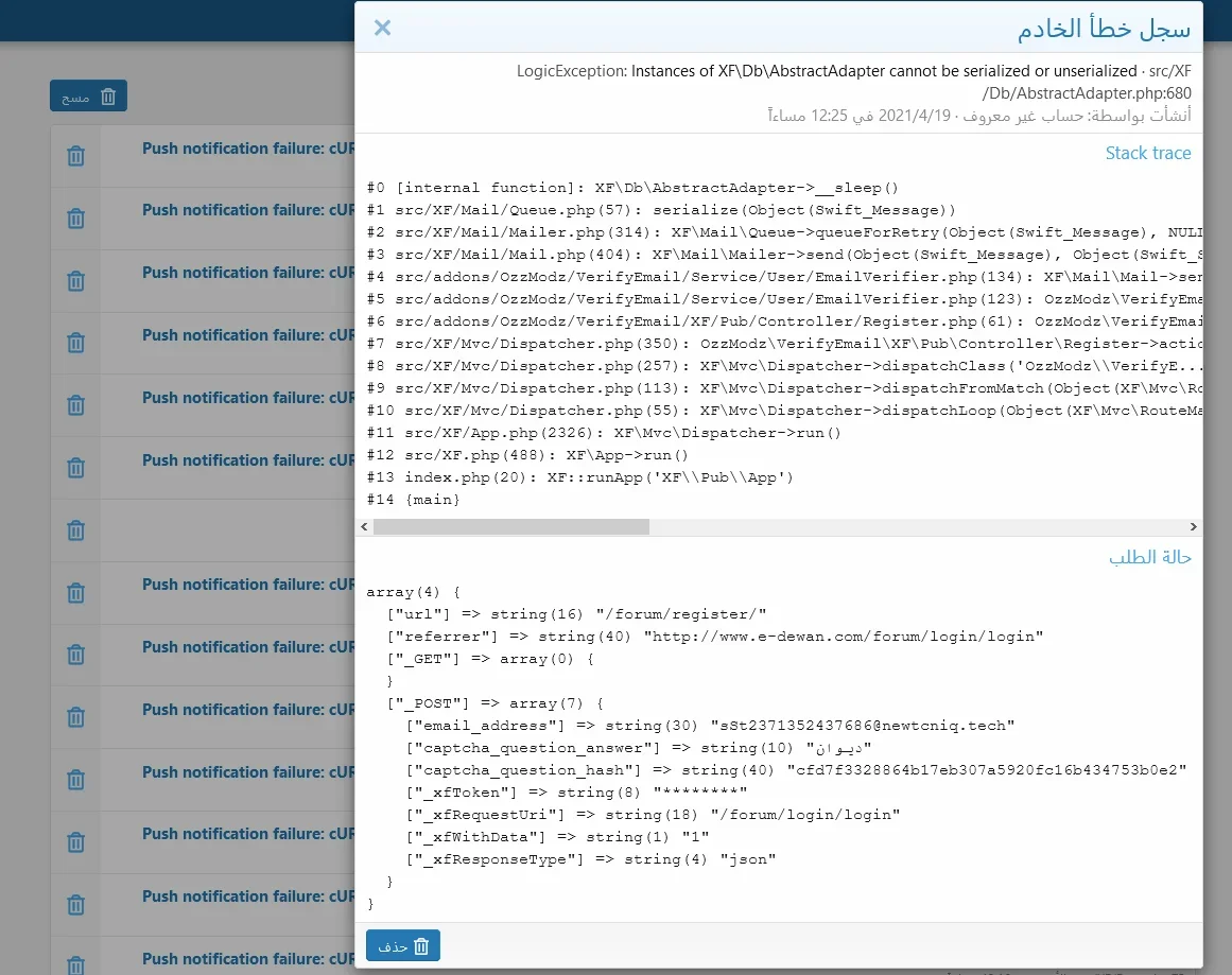

there are errors regarding "Push Notification" except one error that I don't know about.
I would be happy If you have a paid service to fix this issue.
I don't know if it's necessarily related, but this error is because of the "[OzzModz] Verify Email" add-on.
