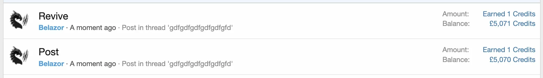

Hmmm, but that's what happened. Would you mind confirming it on your end by recreating it. Earn up to the max limit then spend your credits to go below the limit then try earning it again and see if you could still earn.
I currently use these settings on my test board:
I have this amount of credits:
I then posted in a thread:
There are no skipped transaction entries in the transaction log:
If this is not the correct way to test this, could you please specify the exact setup I need?
