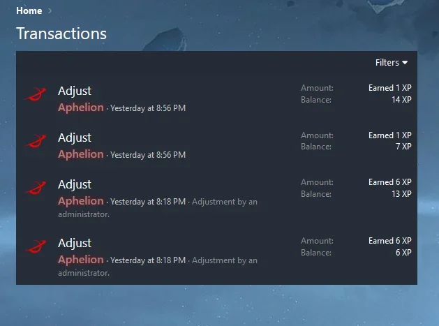

However when viewing the transaction log on the forum itself, all administrator accounts are only able to view transactions involving their own account. If they adjust credits on another account, the transaction is completely invisible unless in the Admin CP.
Is this intended behavior or is there some way I can make it so administrators can view all transactions on the forum transaction log?
EDIT: To clarify, when I click the "Credits" button in the nav bar, the only transactions visible on the page are ones where the currently active account was the target. Even if the active account is an administrator, it cannot view transactions where other accounts were the target of adjustment. The search function does not work to find other transaction events.

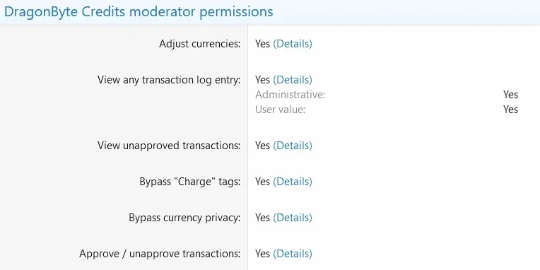

The relevant user group permissions can be found under the "DragonByte Credits moderator permissions":
I think I have those permissions set correctly, but I can't get it to work.
Image #1 is a permissions analysis of the super admin account I am testing on.

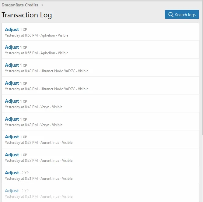

Doing a manual search in the forum transaction log on image #2 still doesn't yield any results that the active account wasn't directly the target of.
