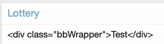

Just purchased the DragonByte Shop today and absolutely love it. I did just have a couple of questions though. The first one being that I get this extra but of code in the lottery description (even if I set no description whatsoever- I will attach a screenshot below). Any idea what this would be about?
8312

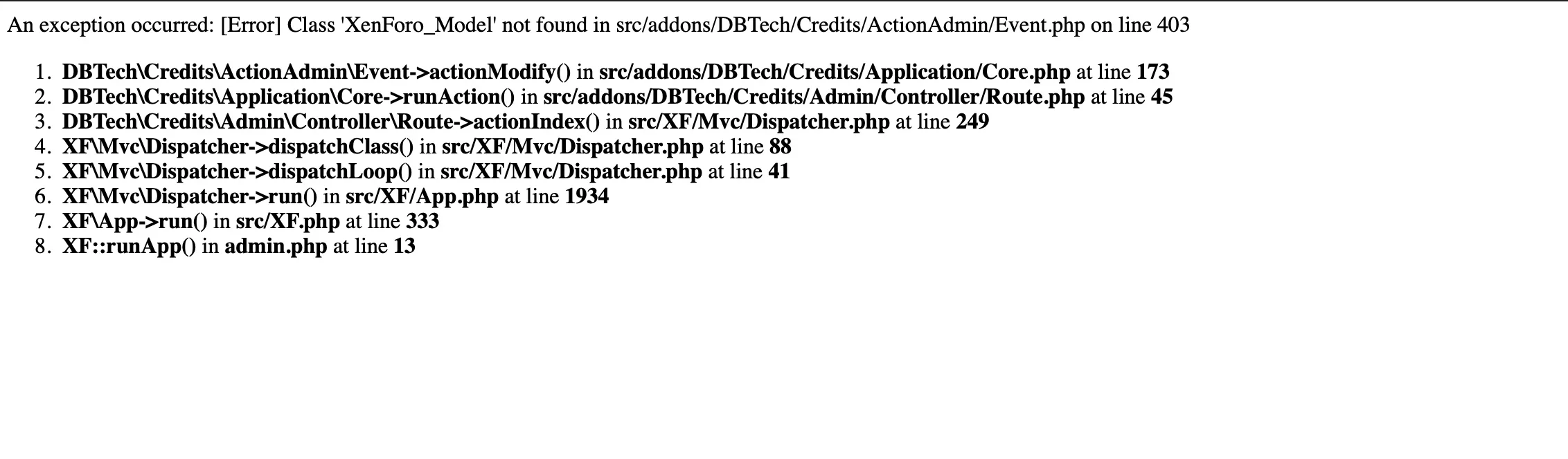

The other two questions I have relate to the DragonByte Credits add-on, but they also tie in to the Shop as well. Whenever I try to create an event based on a Trophy being received, I get the following error message:
8313
Any idea what that one would be about? For what it's worth, I am using version 5.03 of the Credits add-on since version 6.x of the Shop is not compatible with the latest version of the Credits add-on (found that out the hard way). The third question wraps into that as I was just curious if a version of the Credits and/or Shop add-on was possibly coming any time soon so the latest versions of each add-on can be used with each other?
Where are you seeing this?
The Trophy event only works with XenForo 1.5, I'm not sure why it would still be enabled for you. That will be resolved with the v5.1 / v5.2 update anyway, as it uses a better way of loading possible events. Just ignore that event trigger for now :)
The upgrade steps for the Shop mod are in testing now. The initial version of v6.1 for Shop will only contain the Items, not Bank, Steal, Lottery or Trading. That is also the planned order of updates to re-introduce those features over the course of the Alpha period, before I release a Beta version with feature parity.
It's worth mentioning the v6.1 update of Shop will require XF 2.1.

Thank you very much for the reply! Alright so it sounds like the name of the game is just to wait for the update (I plan on updating to XF 2.1 when it is supported anyway), which is totally fine with me. :) In terms of where I am seeing that extra bit of code, I see it when I click in to view more information about the lottery. When I click "Lotteries" in the sidebar, it shows me all available lotteries (I currently only have 1 going), and then if I click the name of the lottery, it brings me into a more detailed page, which is where I am seeing that extra bit of code.
