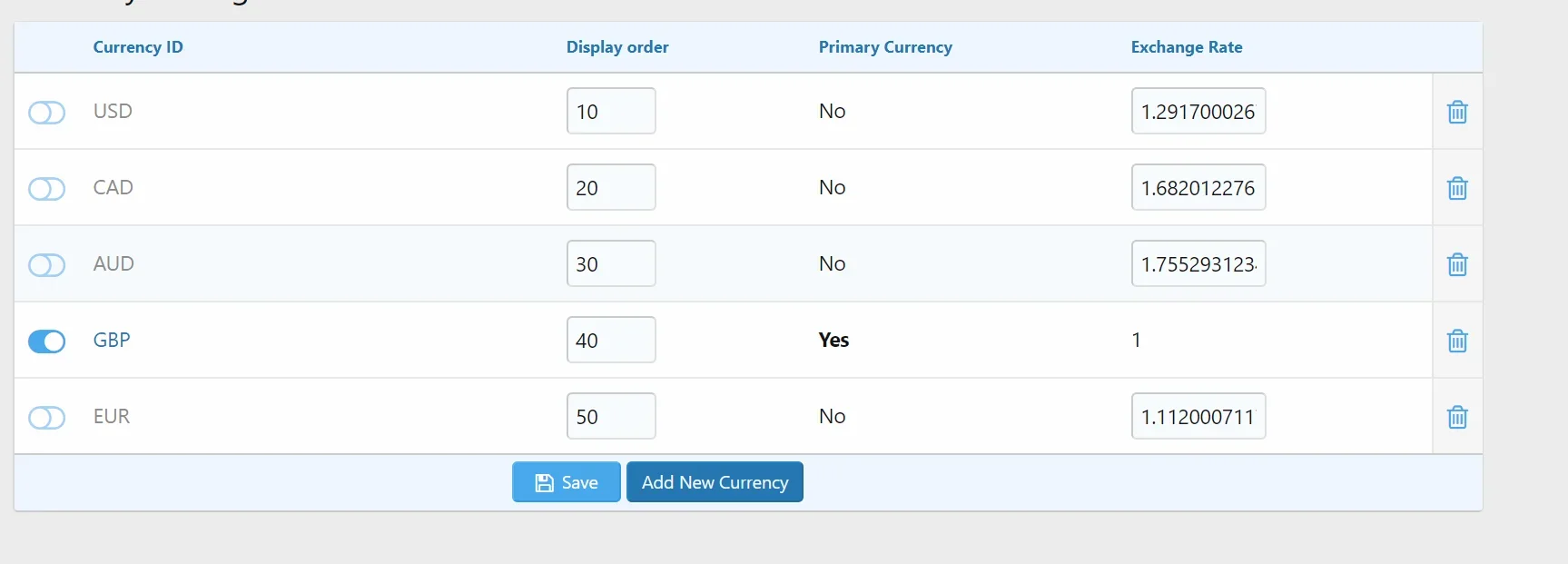

There was no fix in the thread above... My base currency is GBP and set correctly in the currency management screen...
