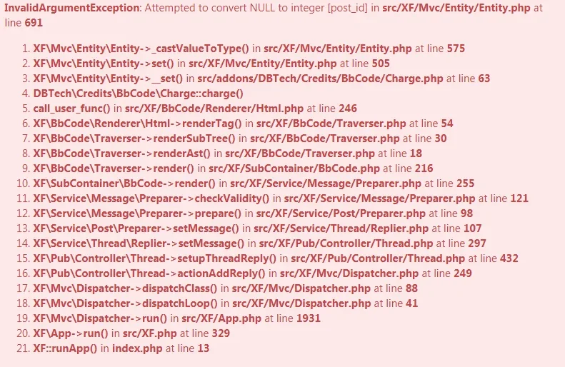

I've added a hotfix that should correct this issue. If you re-download RC1 and re-upload the files, that error will be fixed.
Sorry about that :(
OK, so the CHARGE BB Code is now working, but nothing is getting deducted.
