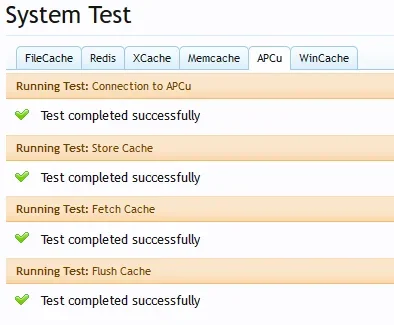

If you want evidence of it working with APCu then here it is:

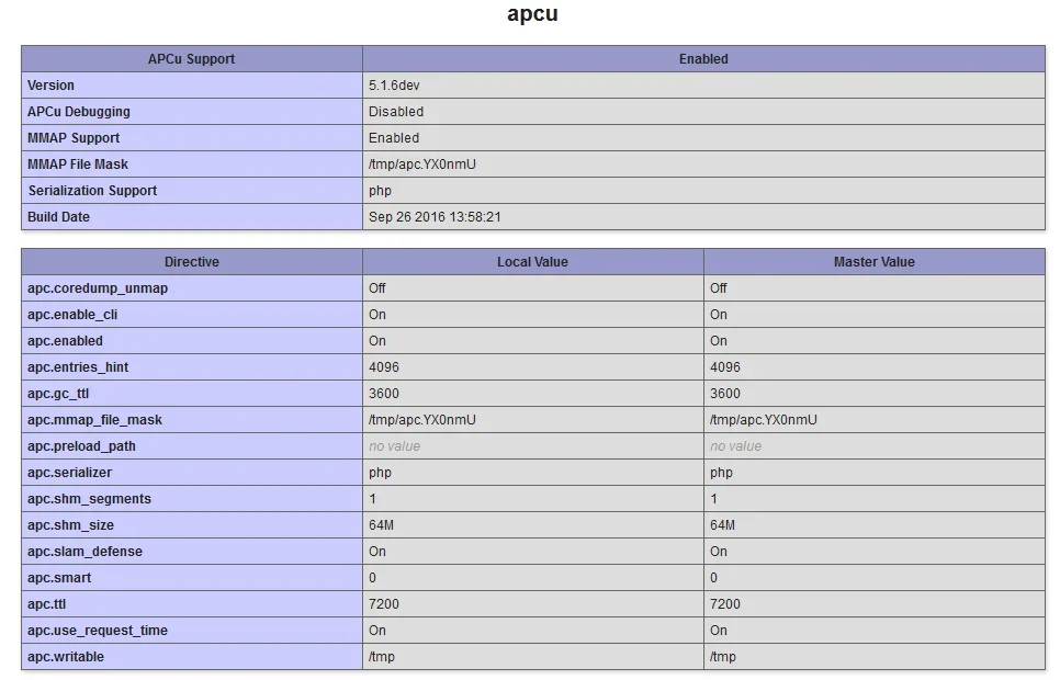

You didn't post your whole APCu configuration, here's my APCu configuration that works for me:
If you are having problems adjusting your APCu configuration you will need to contact your host, as we do not have the ability to adjust server-wide php.ini settings for you.

Can you please compare the picture I sent you of my APCu configuration to your php.ini configuration and amend anything that's different?
If you need help editing php.ini, please see the manual here: PHP: How to change configuration settings - Manual
Nothing needs to be placed in config.php for APCu to work.
I will compare your phpinfo with mine, and make the same changes in the ini file as you have in the picture.
