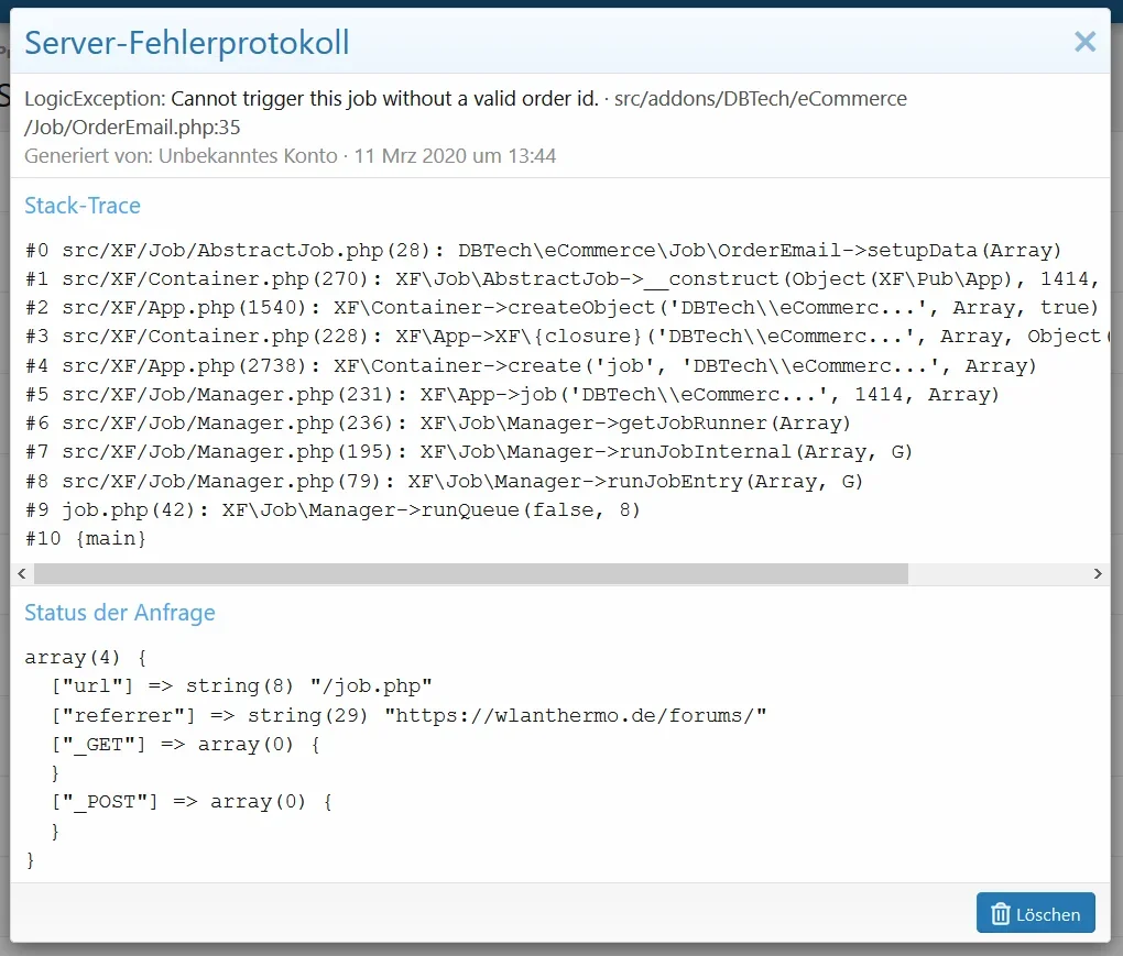

Question Cannot trigger this job without a valid order id - OrderEmail.php
Mayby. Not common with us. But maybe at some point for testing purposes. How can this lead to an error? The error message comes 4-5 times every hour.
The cron job is reminding people about pending orders in their cart (orders that have not received payment nor are "Awaiting payment"). You should not delete orders manually if this cron job is enabled.
If you want to clean up orders, you can do this via the "Delete pending orders" feature in the settings.
Delete the relevant entry from your xf_job table.
