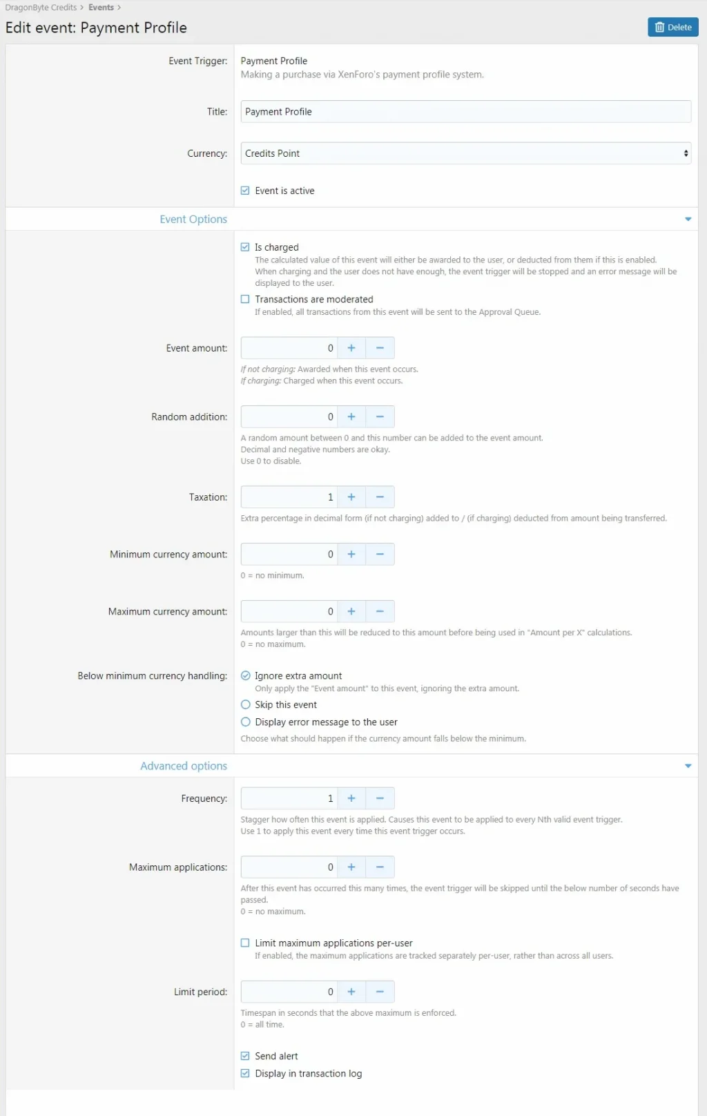

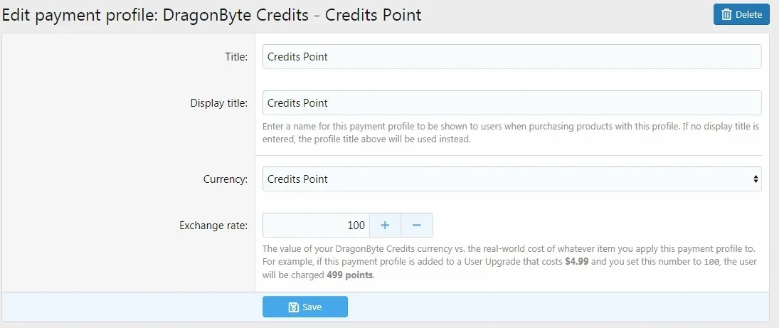

I set up payments for credit system upgrade.
When making a payment, the credit balance does not decrease (even if the account has nothing at 0 Point ) and the account is upgraded.
Error log is empty
Do you test and check please?

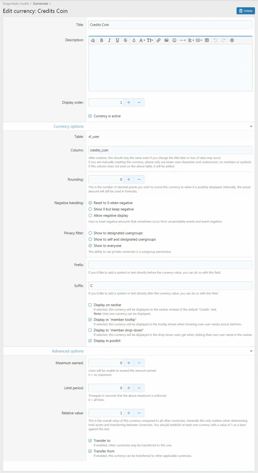

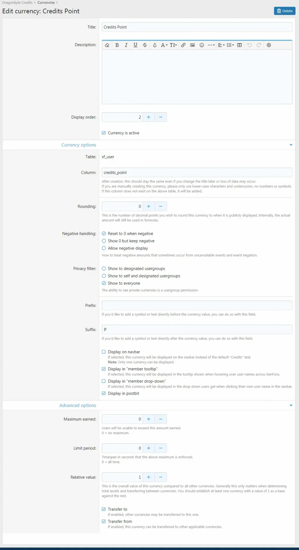

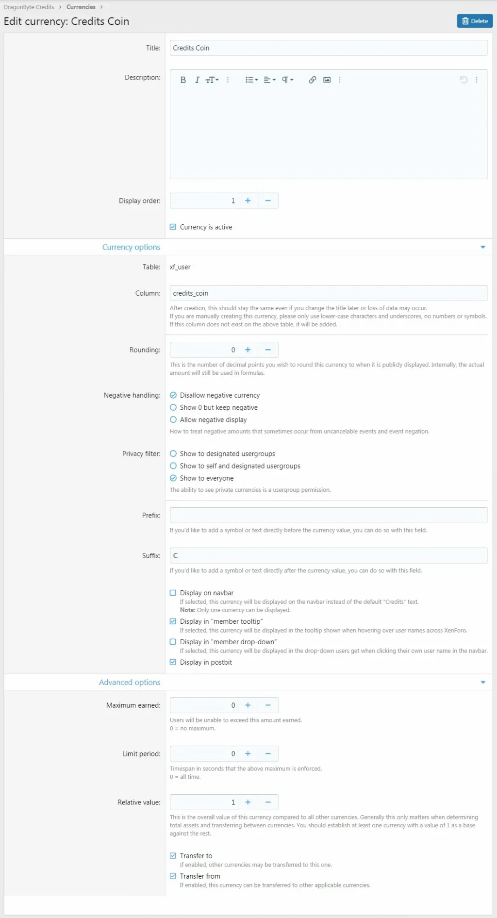

Please check your currency settings:
If "Negative Handling" is set to anything but "disallow negative currency", the user will be allowed to spend credits even though they don't have enough credits.
Can you tell me where is Negative Handling?
I'm using xenforo 2.1.12, so I can only use DragonByte Credits 5.6.4, the highest version for xenforo 2.1 that you provide

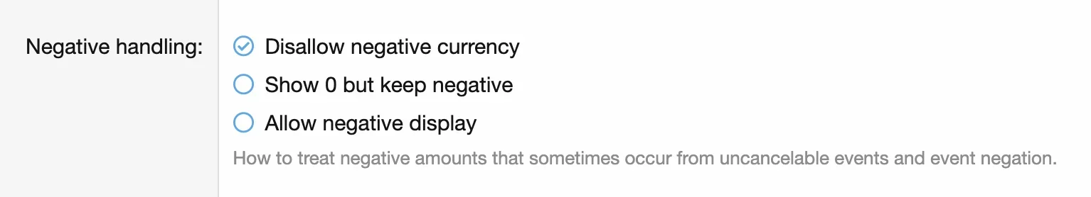

It’s in the currency settings, expand the menu and click Currencies, then click your chosen currency.
Choose the first option in the negative handling setting. The wording in the 2.1 version & older is incorrect.

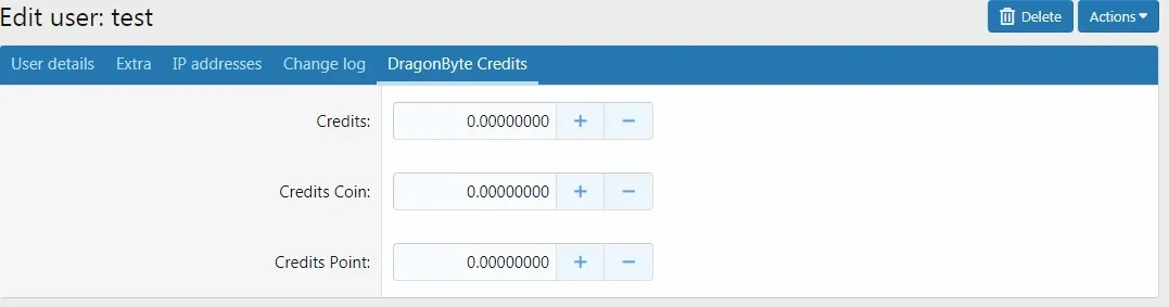

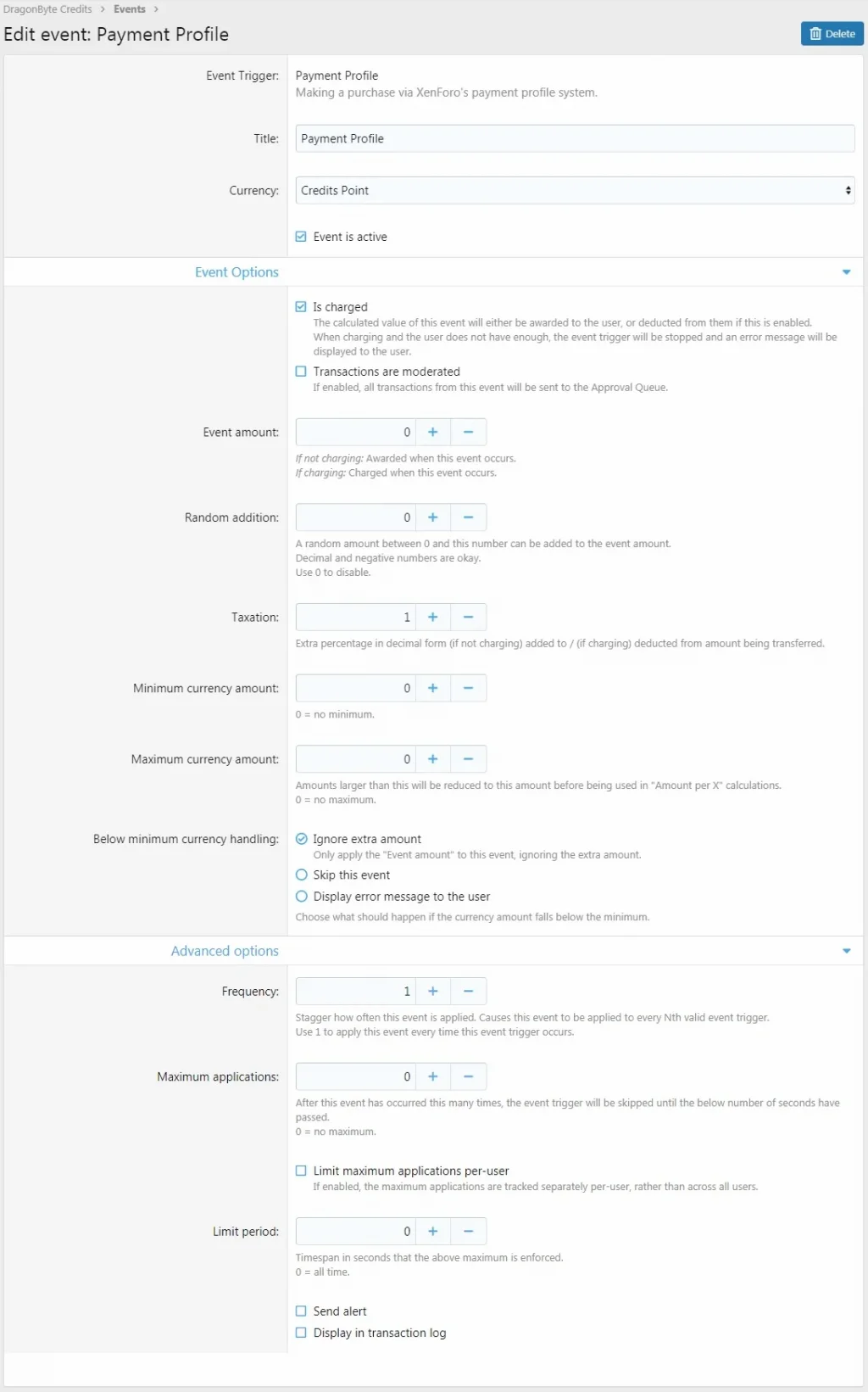

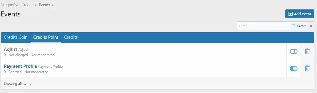

I chose as you instructed, the account value is still 0
but the payment function still works and for upgrade
1626159830047.png1626159853366.png1626159873401.png1626159906120.png1626160010618.png
without any change in the value
value is always 0
but the function is still for payment and account upgrade and the value is still the same

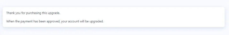

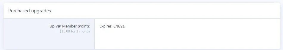

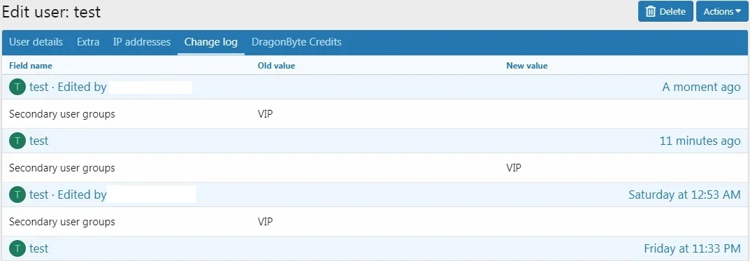

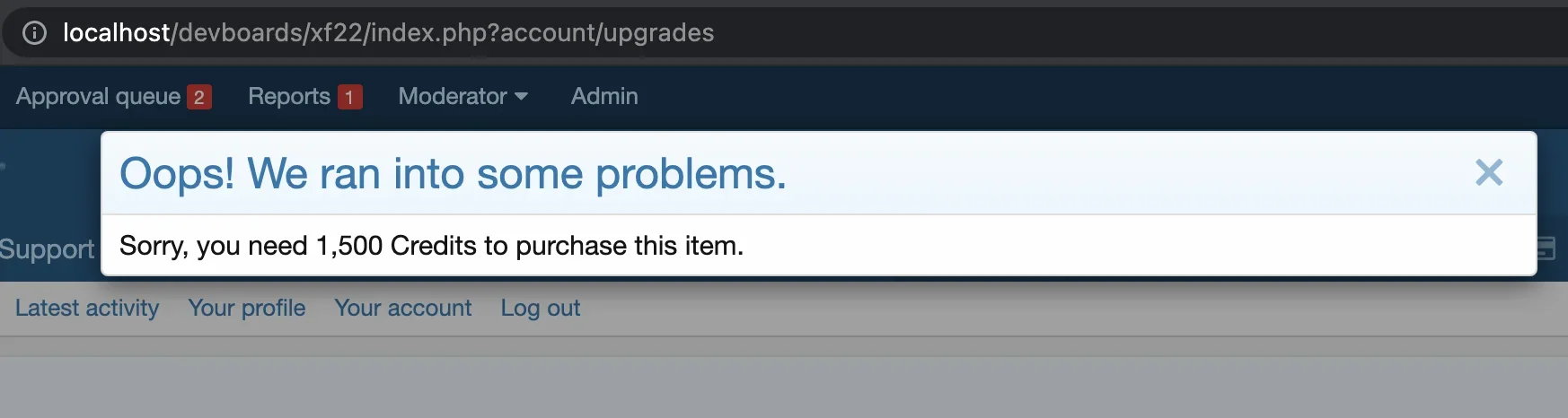

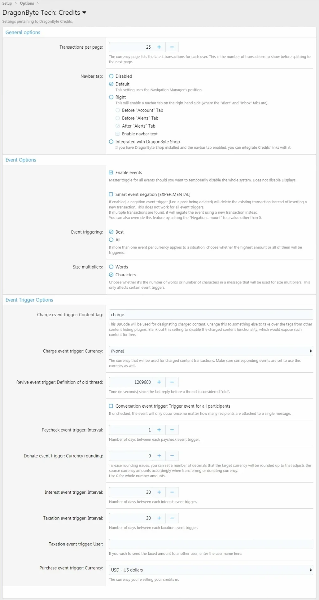

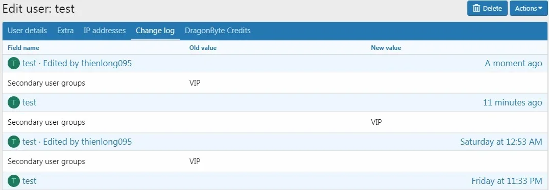

this is all when i update to latest version xenforo 2.2 and dragon credit new
but it still pays for the account and upgrade the account, even though the account has nothing

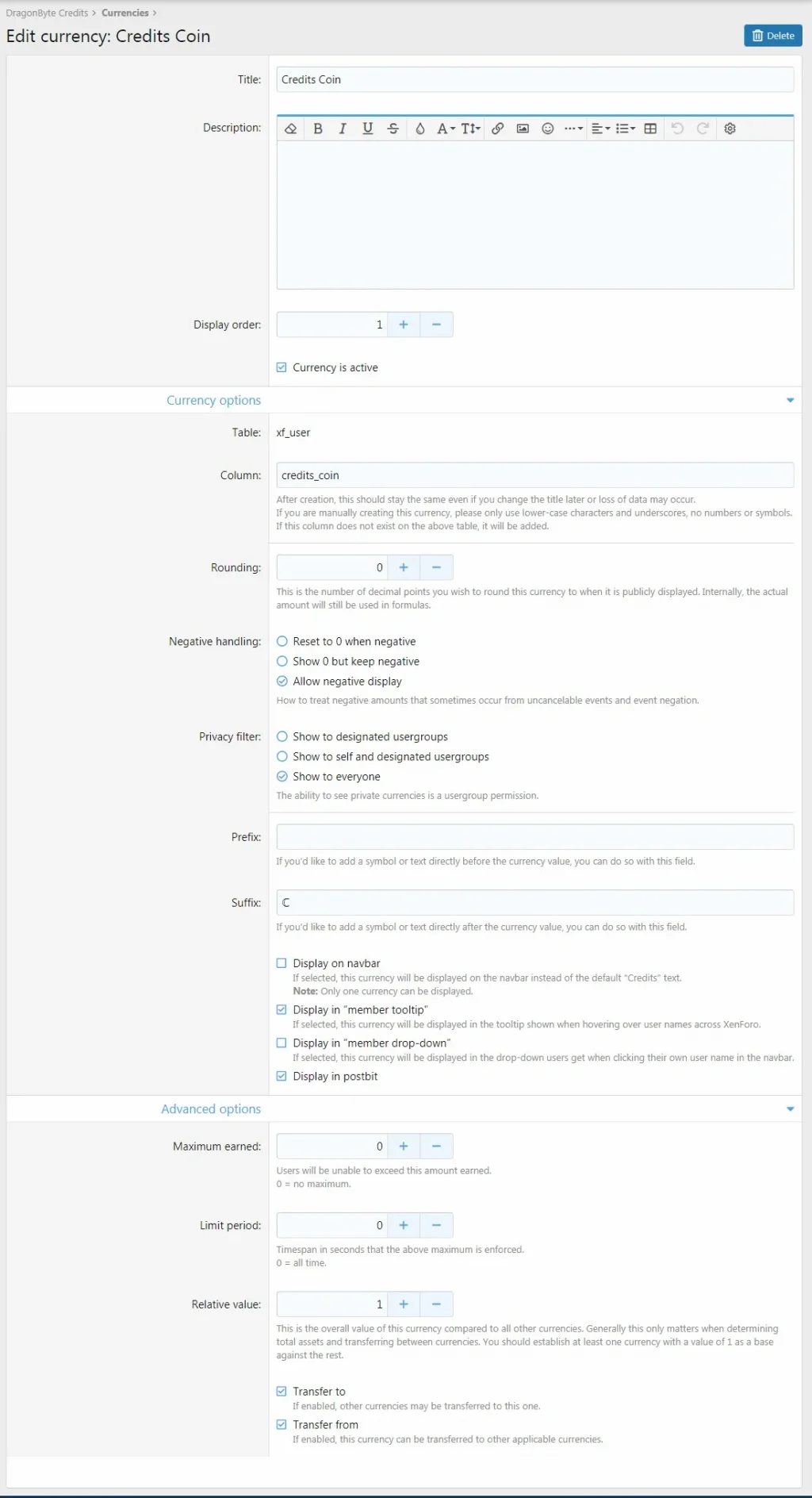

1626765376746.webp1626765422096.webp1626765619027.webp1626765654280.webp1626765717006.webp
i am using themehouse IO interface will it affect addon operation? because there are a lot of addons I use that affect and have to be edited to be able to work
