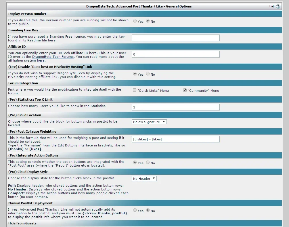

Could you give me screenshots of your APTL vBulletin Options page, so that I can replicate it exactly on my test environment?
If I can replicate it there, I'll fix it and let you know when a fix is available. If not, I'll be back asking for admin/ftp :)
