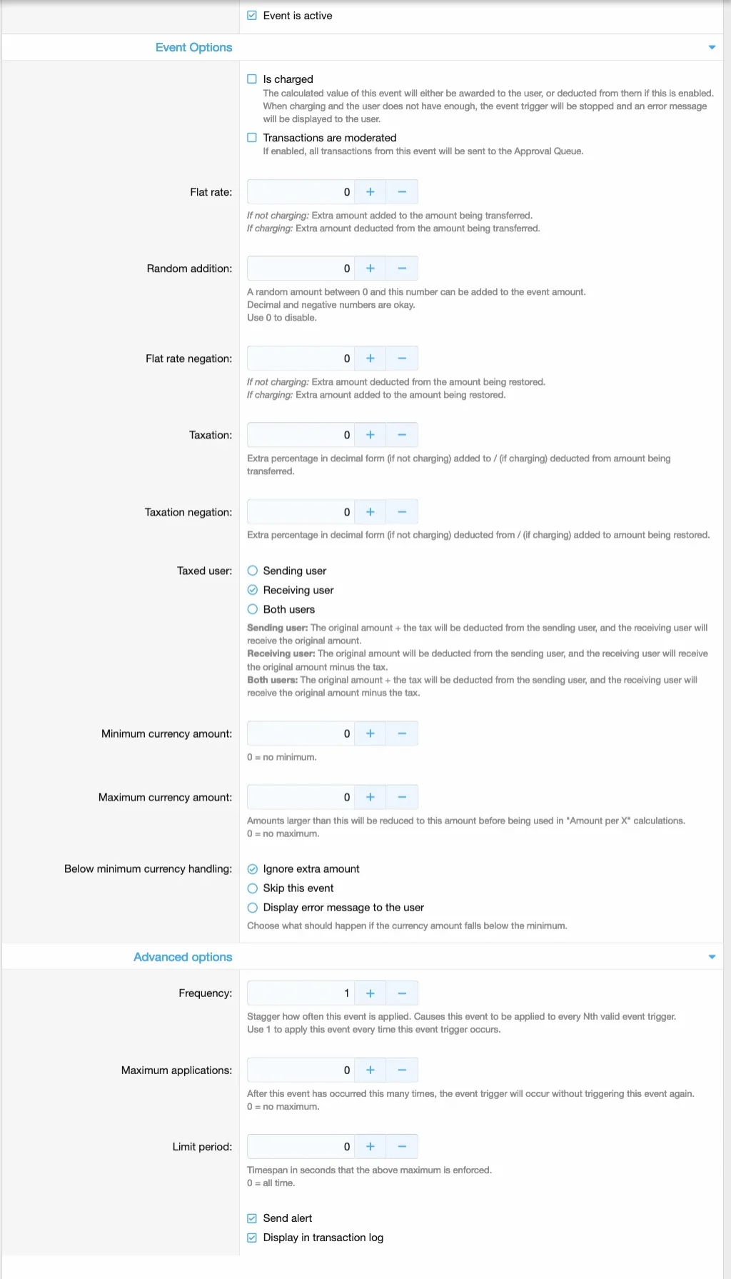

I had an incident on my forum where a user was ripping people off, so we had to remove currency from them. Unfortunately they already spent some, but we wanted to put their currency below 0 so they have to earn it back. The currency settings mention negative handeling, but I can't find how to actually give them a negative amount.
If you have set up the currency to allow negative numbers, choose "Take" in the Adjust overlay and enter the amount of currency you wish to take away from the user.
For instance, if they have 750 points and you want them to end up at -250, enter 1000 in the "Amount" box.
I tried this, but unless I missed a setting somewhere, it's blocking it from going through. It would say something like "user doesn't have 1000 credits to spend"
Hello @Jeremy,
I've made a change for the next version that should address this. The "does the user have enough credits" check did not take the currency's negative handling into account, and it should now only error if the negative handling is set to "Reset to 0".
