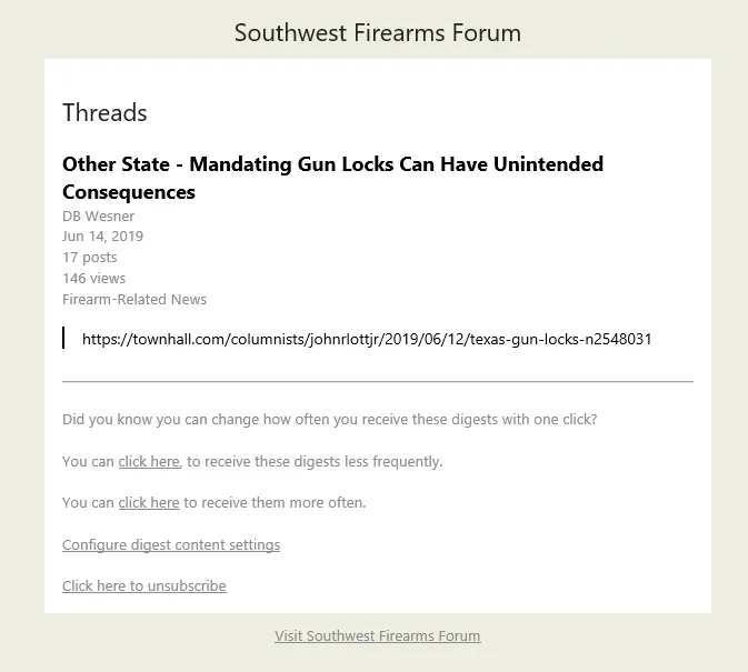

The site I'm testing this on averages a few new threads per day and I have it set to send daily. I had advanced sorting enabled and each day the digest would have (mostly) duplicate threads. The images below are from June 9th, 10th, and 11th. During this period we had 8 new threads and 53 posts.

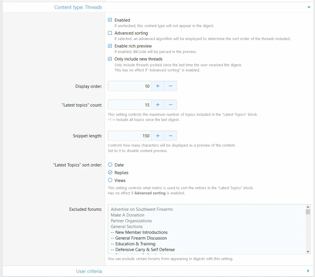

Advanced Sorting Off
I turned Advanced Sorting off yesterday, using the following settings with the goal of sending a list of new threads.
I did not receive an email when the cron ran last night. Using the test function I received the digest, but it only contained a single thread (there were 10 new threads posted yesterday).

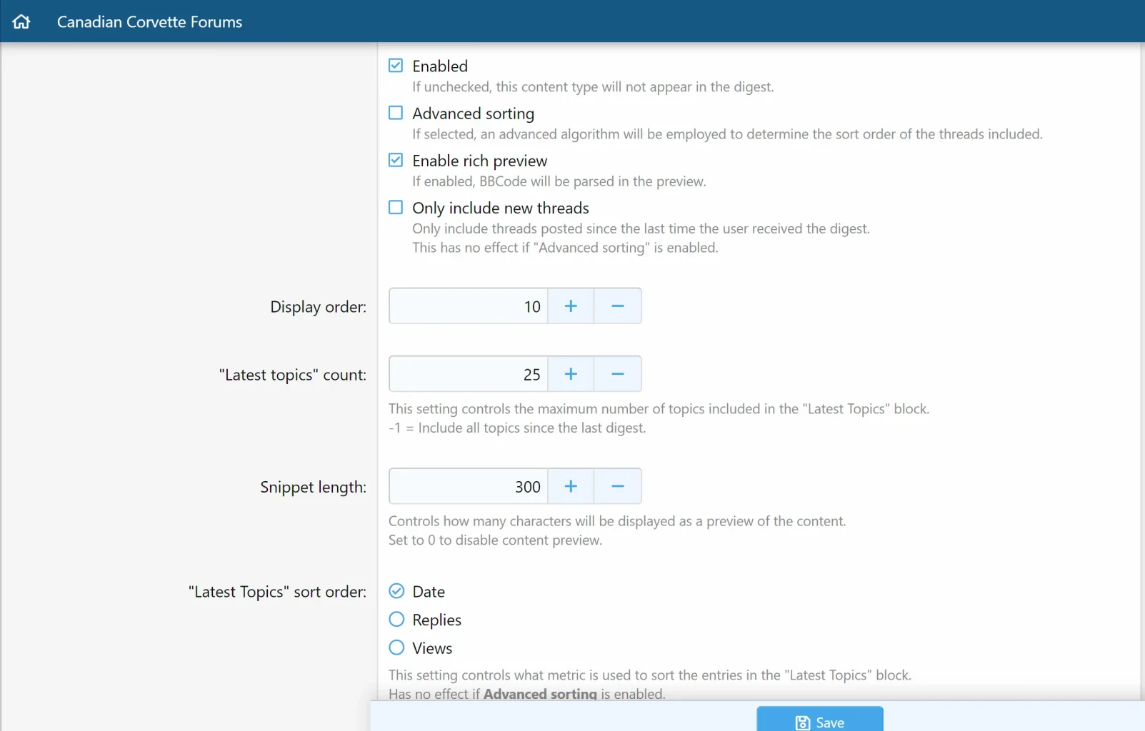

Likewise I'm receiving none to max 1 entry in the digest for my daily digests. It comes just after midnight local time (EST in my case). I expect to see ALL threads with new posts since the last digest (as I have new threads only UNchecked) but again not working at all.

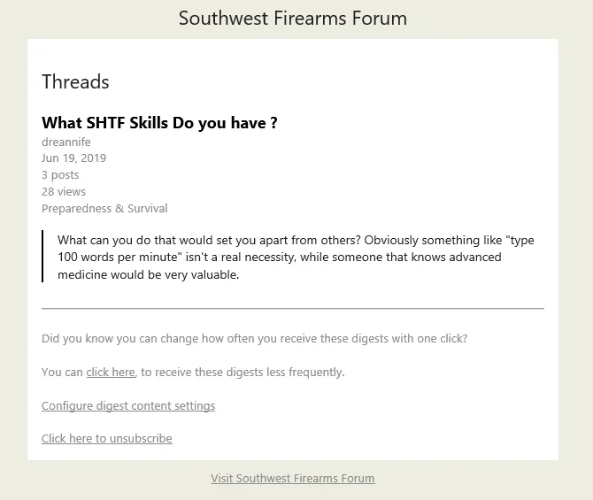

It would be great if you could test the weekly schedule as well, as I'm not sure when exactly I'll have time to make the change mentioned in my previous post.

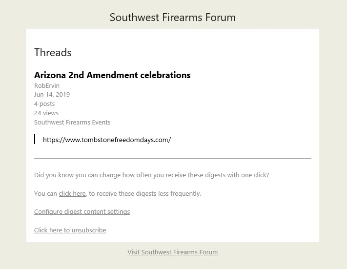

I've confirmed the same for the weekly digest, only one entry in the newsletter. I did notice the thread is different from what was sent to the daily guys though, it's a thread from June 14th versus June 19th.
