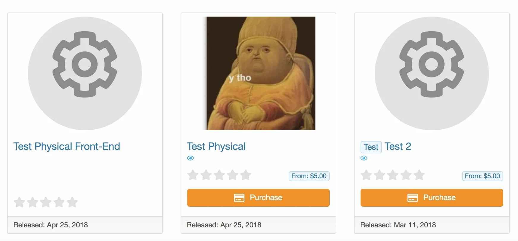

The default product icon hasn't worked properly for a few versions - the icon is off-center. I was able to fix this by changing the display type on the container (.productList-product-grid.node a.avatar) to inline-flex.
Also, it might not be a bad idea to split the product logos from the avatar css, what with avatars having a default border-radius of 100% now.
That didn't fix it for me, at least not fully.
Before:

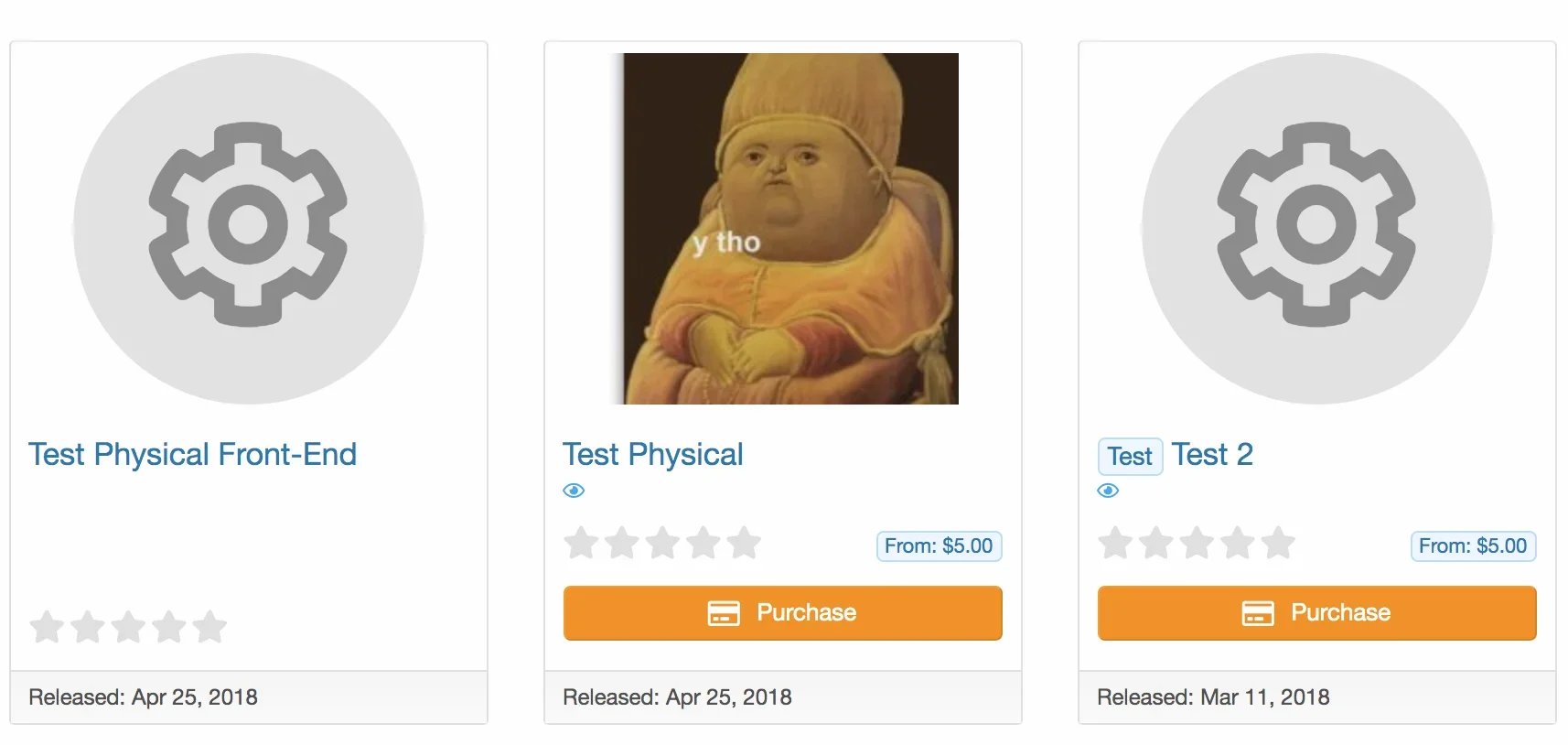

After:

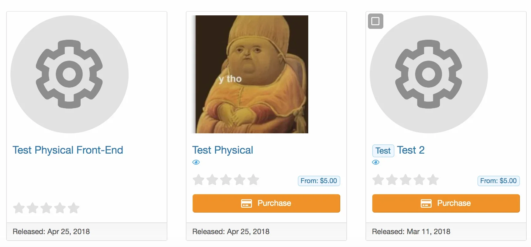

The centre alignment was lost.
From a quick experiment, it seems like a better fix would be to set vertical-align: middle; on .avatar.avatar--productIconDefault > span:before:
