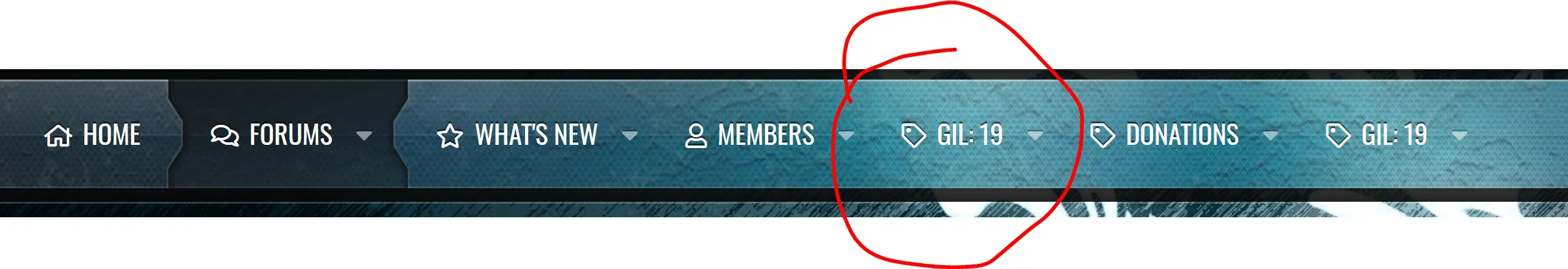

I have both Credits and Shop add-ons. I want the Credits to show up as the word Gil in the nav bar. That works fine.

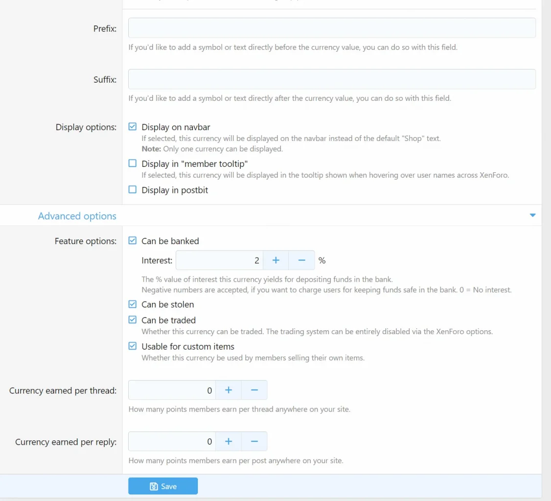

For some reason when I link the Gil currency in the shop options it is changing the title of Shop in the nav bar to also say Gil. I do not want this. I've tried un-checking the Display on Navbar option in the shop settings, but it won't save the changes. Any idea what I need to do to correct this?
EDIT: Here's a picture of what it looks like with the part in the red circle being the Shop:
And here's what it looks like in the Shop settings:

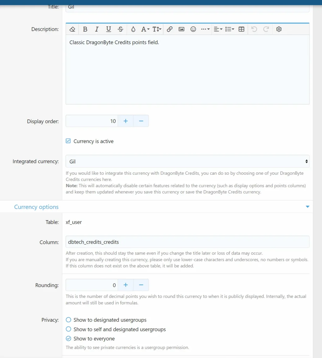

I recommend changing the Navbar Tab options in the Credits mod to be Integrated with DragonByte Shop, as it'll then stop having two separate navbar entries.

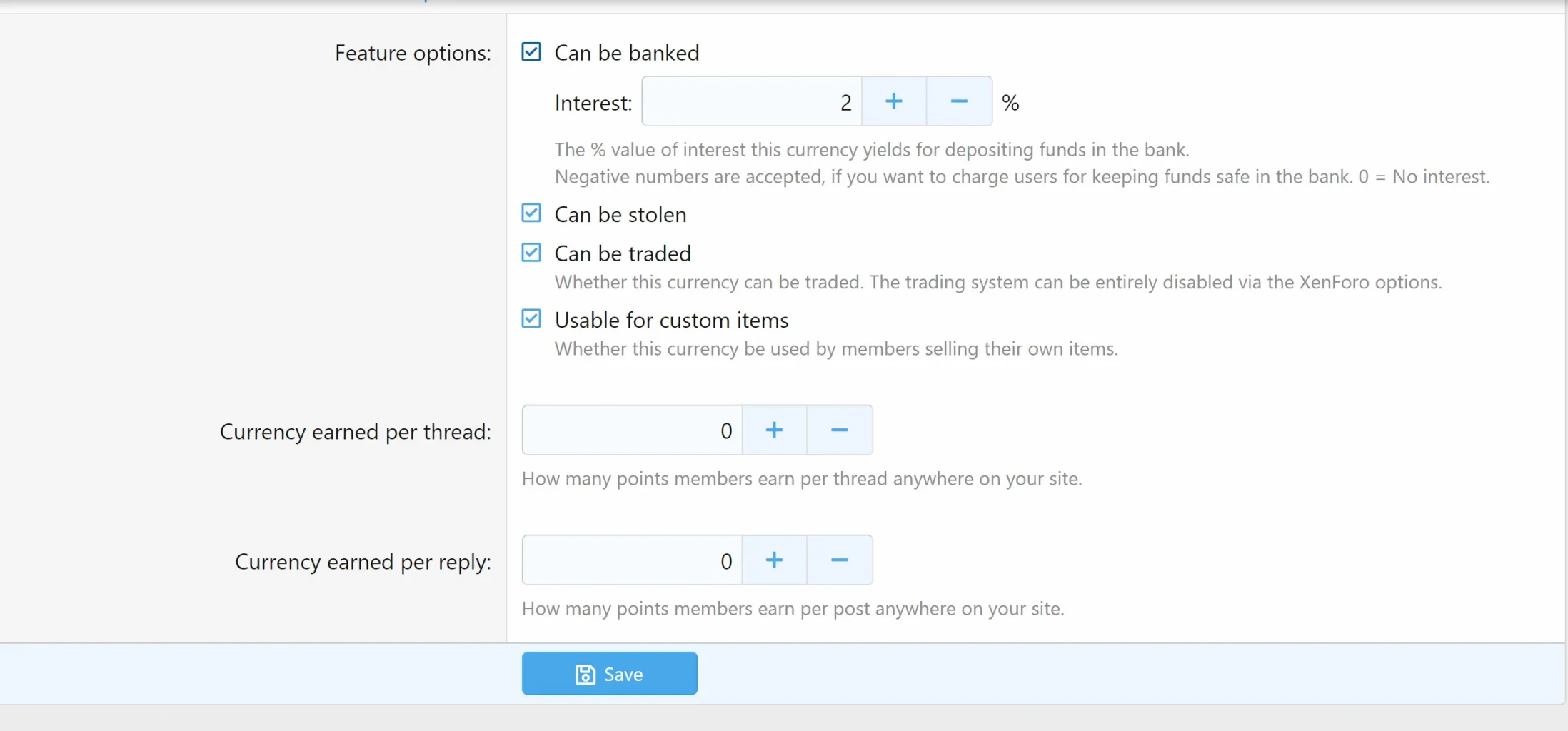

I'm having another issue with the currency. I can't change the value of currency earned per thread and per post in DragonByte Shop > Currencies > Advanced Options.
Can you tell me how I can make it so that posting a new thread gets X number of credits, and posting replies gets Y number of credits? I have no clue what determines how many credits are given for various actions right now.
You need to set up Thread and Post events in the Credits mod. When doing so, make sure you also fill out the "Negation amount" setting for the same value, otherwise people editing their threads and posts gain infinite credits.
