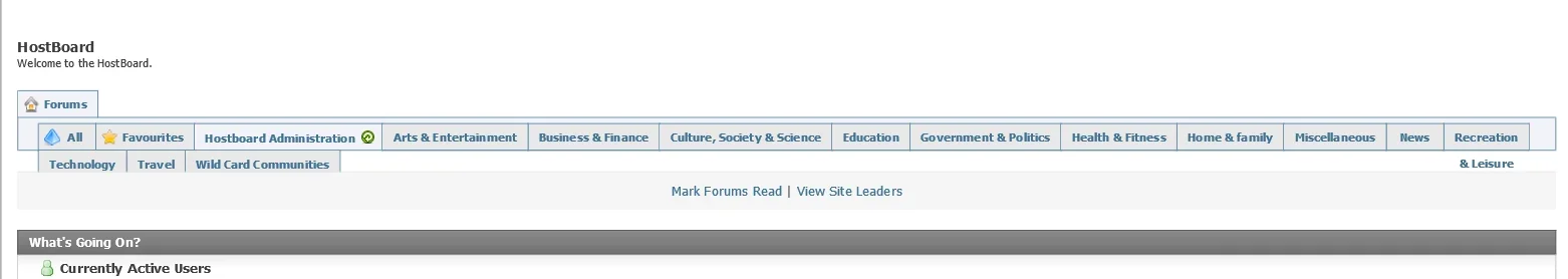

Just installed the latest and greatest (trying to get off of that "other" tabbed system) and there seems to be a few issues...
1. The tabs do not line up
2. No forums appear when a tab is clicked.
Also my tabs look nothing like yours here with the rounded edges. I am probably missing something simple, which is 99.9% of the time :)

The tabs not lining up is more to do with there being more than the line can hold. I will look at how we can improve that in the system. You might want to reduce the length of some of the tab names, or consider grouping them into category tabs (like the 'Forums' tab on the top line).
If forums aren't appearing, have you selected any within the tab in the Admin Control Panel? Only AJAX Tabs (not the Category Tabs) will have the option to do so, and Favourites and All are system tabs so aren't editable.

For initial testing I selected "All forums" for the tabs but still nothing is showing.
That is the default 'all forums' tab and doesn't have an option to select forums. Instead, check one of the other tabs other than Favourites (which also doesn't allow selectable forums via the ACP). I'd suggest 'Hostboard Administration' as the tab to edit. You will see then a select list. For it to work correctly you need to select the forum/forums you want and make sure that any parent forums or parent category forums are selected right to the top level.
