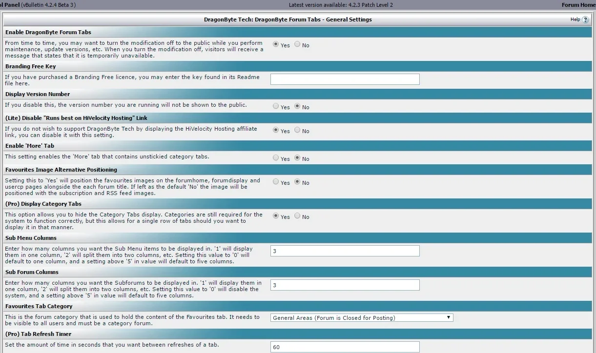

What are the settings you have for the tabs in the AdminCP? Sometimes one thing can override another. Are you using Cookies on your site as well?

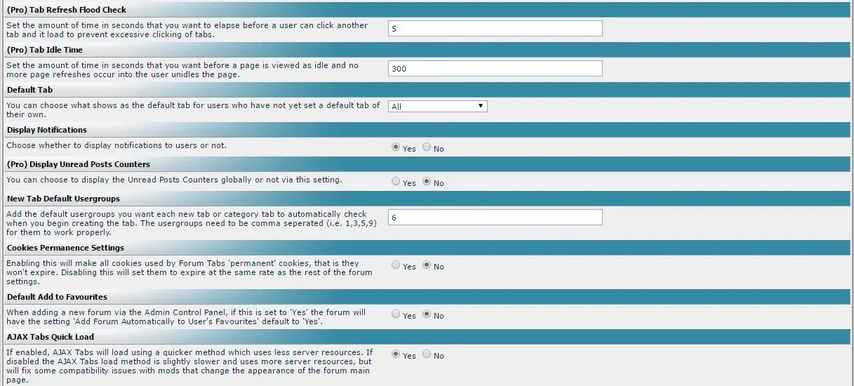

These are the current settings for the tabs.
Also, any cookie settings should be default from when the forum was set up. I typically don't tinker with them.
Have you changed the setting Default Tab? It's on 'All' at the moment.
