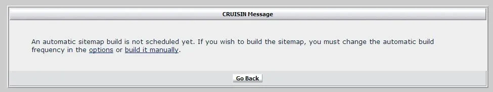

Looks like it's getting closer. I set the sitemap to run automatically and at the given hour it cleared the old sitemap files but did not run. Now when I check it by running it manually through the cron job I get this:
An automatic sitemap build is not scheduled yet. If you wish to build the sitemap, you must change the automatic build frequency in the options or build it manually.
I went to the options page (through the link provided) and resaved the options. Option for "Days" is set to 1. Reran still same message.

I get:
I'm not sure how it is all coded. I built the sitemap earlier today manually, so that may be stopping the cron job from running again today. I'll report back tomorrow on whether it runs on its own or not.
When testing and trying to run the cron job manually, why does this message popup:
even if I have this in the settings:
It seems that the issue for me revolves around the "days" setting. It doesn't matter whether I set it to 0, 1 or 50 when running the cron job manually I'm always getting the popup message saying I "must change the build frequency". I assume when the automated cron job tries to run it hits the same message/issue.
Did you adjust the sitemap cron job build time setting to the current hour (server time) as discussed previously before attempting a manual cron job build?
The error message is the same as the message you'd get with the frequency setting.
