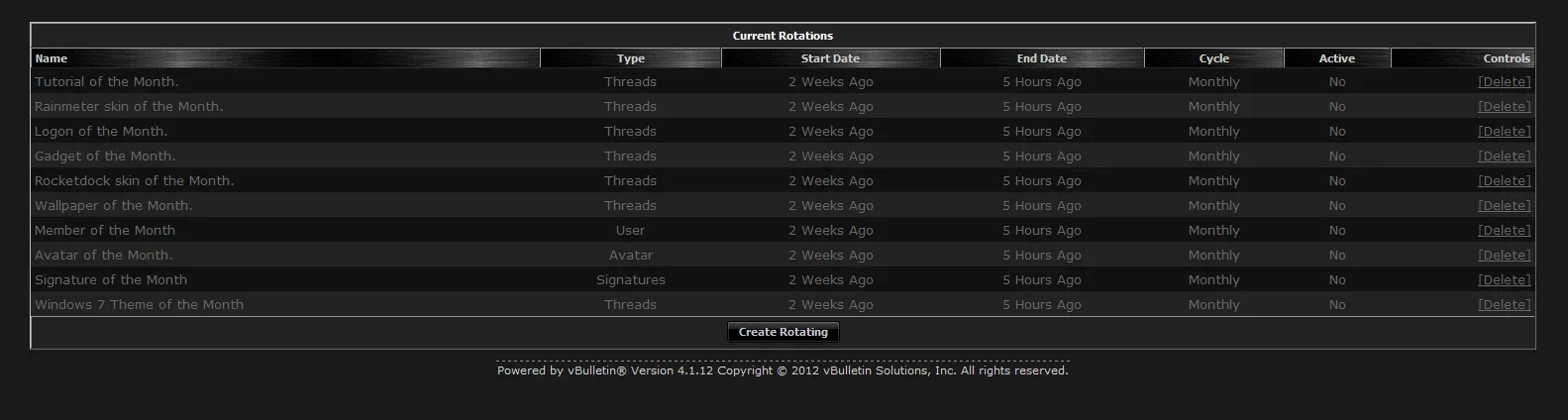

I really dont understand how these current rotations is working. I created them last month, and they are now after they finished not active? How does this work, is it not suppose to be active every month?
Not how you have it setup. With the rotating nominations, the end date is the last date you want that type of nomination to work. So say you create a rotating nomination that you want to run monthly. You will create it with the end date of something in the distant future, like 12/31/2059. Each month it will see if that nomination has ended, if it hasn't it will create a new current nomination. Think of the rotating nominations as a template that the cron job looks at to create current nominations.
OK, I understand. So is there a way for me to edit these, or will I have to set them up completely new again?
If you have database access you could go into the table dbtech_vbnomnom_rotate and set the active field to 1

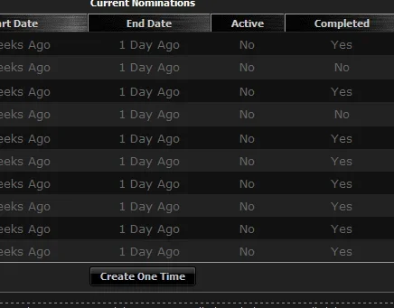

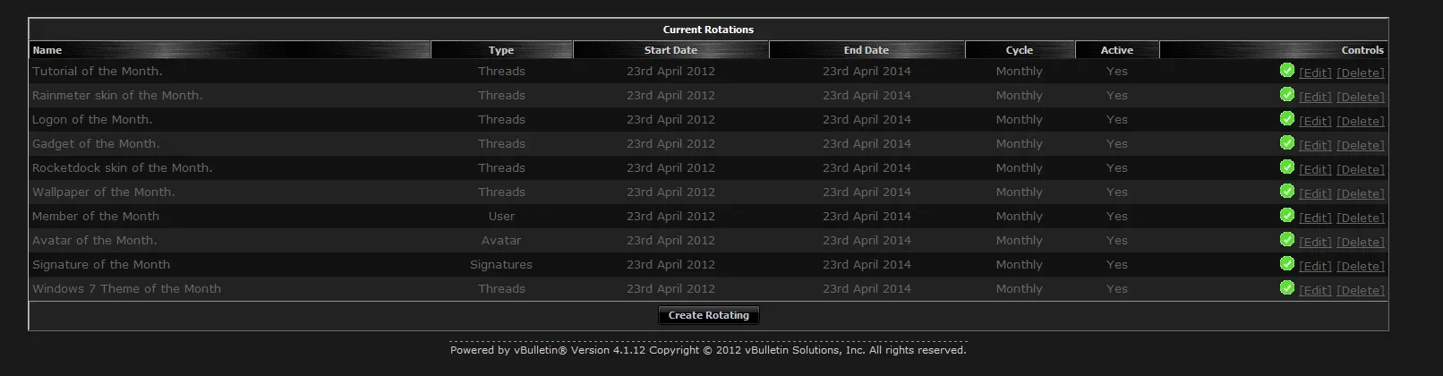

I really don't understand this. The rotating nominations are now active:
Yet under current nominations they are inactive:
And on my forum it is not active:
What am I missing here? Thanks.
If today is the day of the month that the nominations are supposed to start you can manually run the nominations scheduled task. The problem is that when it ran last time it disabled the rotating nominations so there were no new one time nominations to create.

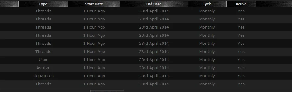

It was set to start on the 23'rd. And in rotating nominations it says it is active and started 1 hour ago:

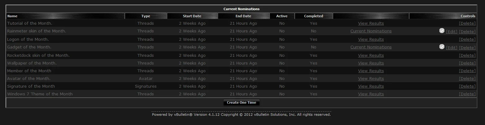

I ran the scheduled task again now, but still under current nominations it is still showing inactive:
You should be good to go now. They're all created, ending on May 1st and the new ones should start at the same time those end. Take a look on the 1st and let me know if it doesn't go as expected :)
