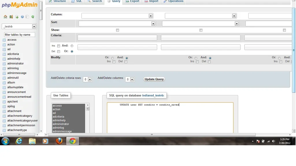

I think I forgot to post the image for my above reply
Okay, thats looks great. Run the query I already gave you, there, and then go back into admincp and delete the savings currency. Should then be all set.
I tried to run the query you gave me but it said, "You have to choose at least one column to display."
I'm new to this so the obvious to you isn't obvious to me :)
According to your screenshot, you tried to paste under the "Query" tab. Click the "SQL" tab, and it should give you a solitary textarea to paste into instead.
OK that worked for me :RpS_thumbup:
Ran the query and it worked and deleted the Savings currency just fine.
