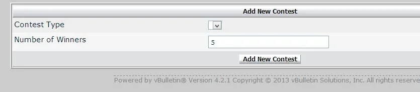

Seem to be having all kinds of issues using this program with 4.2.1
The create contest has no contest type in the drop down menu.
Still getting errors uploading the vbactivity-export file as well. Missing ID

When you say table, you are not talking file size correct? Is there a way to check the table within vb?

Prefix on config is vBulletin where would that go on this string
I went right up into the root directory and there is no table by that name at all. All the other ones appear to be there associated with the vbactivity

Just ran that query and it came back with 3 pages of info on it
Okay, then the issue is most likely that you have another product of some description interfering with your datastore cache. Are you running vB Optimise Lite?
If so, please try flushing its cache.
Its a bit weird becuase it worked perfectly before I put it on 4.2.1 but I had to delete all my files and do a fresh install of vbulletin and used a backup of a database I had which contained the vbactivity data. But once I uploaded a fresh copy of vbactivity you would think it would work fine
