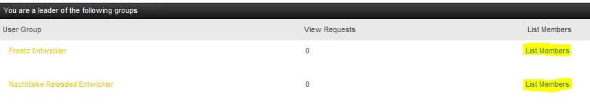

Hi Fillip H.,
The link in the User Control Panel for Members List does not work when Rewrite Member List URLs is set to Yes.
It all users of the forum are shown and not the individual group.
Best Regards
