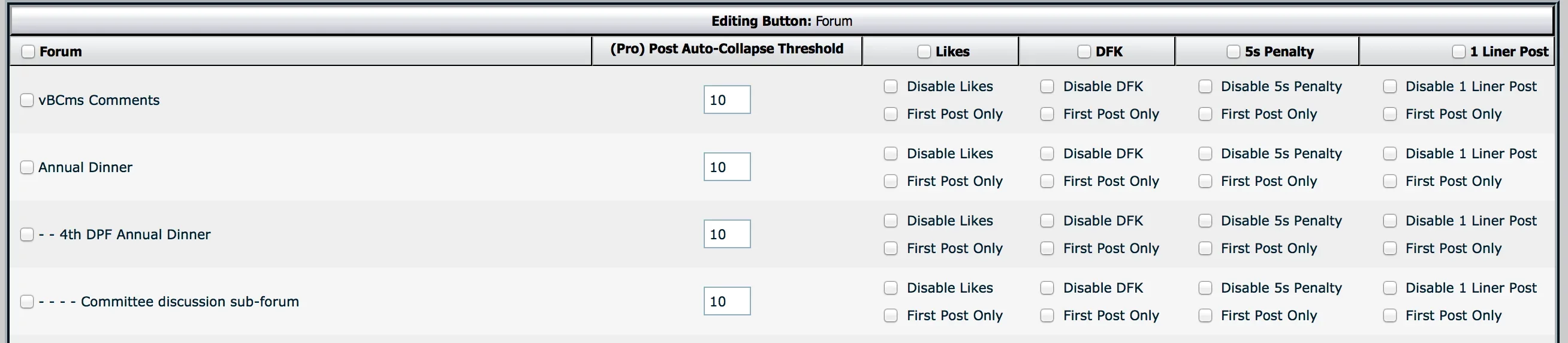

I just dont know how to make this works... i saw in last post that i need to input a value, but didnt find where or how to.

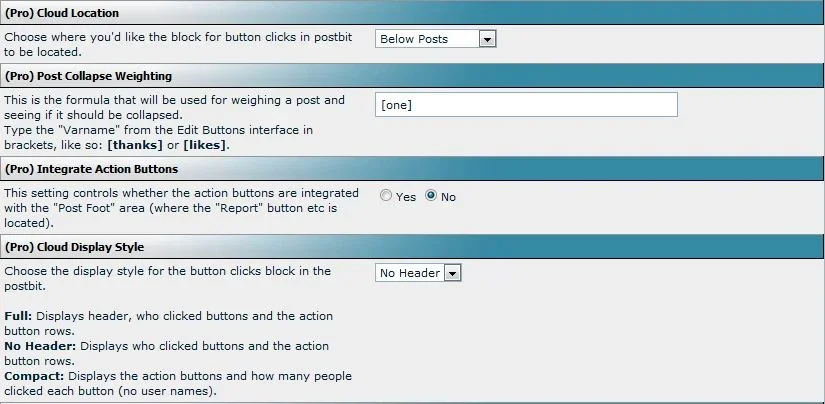

This is what i have (default options):
What do i need to do or what im missing? Im just using the likes and dislikes button with 1 and -2 values.

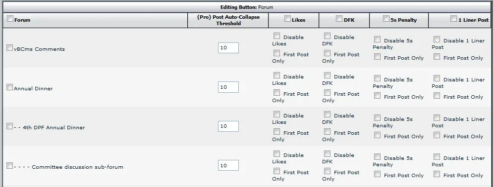

If you only want to collapse it when the post has reached 5 dislikes, set the per-forum threshold to 5 and set the formula to [dislikes] :)
The Per-Forum Threshold is in the "Forum Manager" menu entry under DBTech - Post Thanks :)

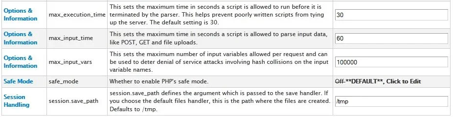

This can happen if your max_input_vars in php.ini is 1000 or less. Please increase it to 100000 or higher in order for it to update correctly :)
Done changed to 100000.... But still no luck... the value 10 still the same and nv get changed to the value i set. Any other advise? thanks
Did you restart Apache after changing it? Check the View PHP Info screen to confirm it changed the value properly.
