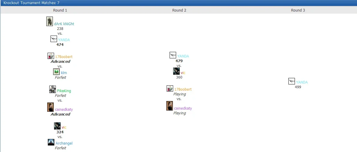

1st player finished his rounds upto Round 3 and was waiting for the opponent, he noticed later on in the evening that he had these notifications.
Today the next user that has advanced to Round three has also suffered the same he has: 4,294,967,370 Notifications.
Not that I know anything but it looks like when they have entered the last phase they both got these notifications.

Just an update, Nothing that i or a user is doing makes this happen.
I logged in this evening and I had advanced to the next round 2/3
I had 0 Notifications - (Just incase it's important) I have advanced as the opponent forfeited his game
I played the game and hey presto...zillions of notifications.
odd thing is that the others that have advanced to Round 2 haven't suffered the same.
I have now advanced to the final round so i will clear my dbtech_vbarcade_matchcount to 0 and await the other finalist and see what happens then...all that can advance to the next level have 0 Notifications

So taking in mind what you have said. no games have been deleted, all players matchcount is currently 0 excluding one who didn't turn up his is still at 1 ~ so why when i just played the game and advanced to next level did i receive zillions of notifications
the explanation you are giving is logical but the logic isn't been played out in situation I'm explaining.
As you know for this tournament i reset all the notifications i deleted all games and set off as if i had just installed the product.
with no interference from me - except setting up the challenge and of course playing the rounds - it has given me -1 (zillions) for no reason. just me no other player.
Remember I was in round 2 - 0 Notifications - all is well everything working as you explain.
play the round to get in to finals and bingo from nowhere -1 why?
