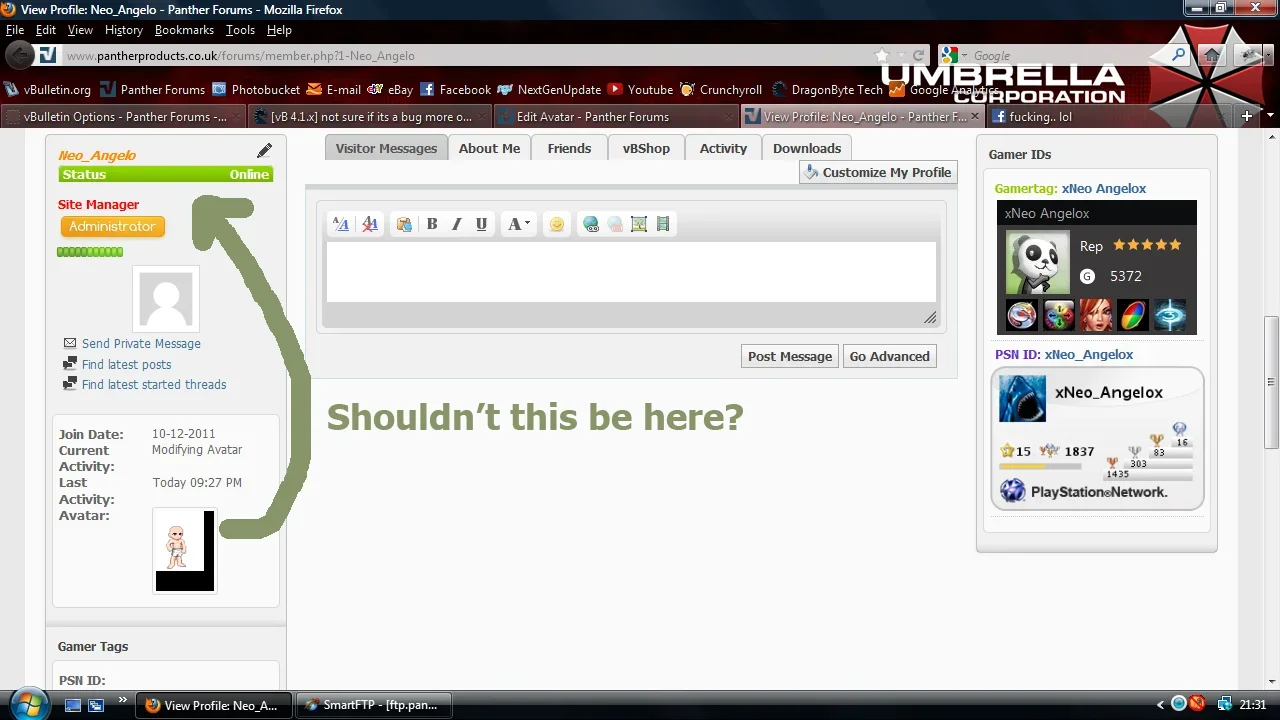

EDIT: Ok i had a play around and i managed to get it working, ok what it is was i was going to settings then edit avatar and clicking use vbavatars having not gone to /forums/avatars.php first and made one, i thought that using that options would direct you to the editing your avatar but it doesn't, maybe you could add that in future versions so that its not confusing, my stuff seems to work now but the only issue was what you mentioned about the pre-defined dimensions, i get a nice black background where my PNGs don't reach the dimensions, (see screenshot) but at the moment i'm not too bothered as i'm just playing around, i'll wait till thats been fixed before i go live with it.
also i found a problem with the mod on view profile (well i consider it to be a problem at least) see screenie:
Yeah, all the files do need to be uploaded to your forum directory, that's also in the readme.txt file :)
This mod does not modify the placement of the avatar in user profiles. The arrow you're pointing towards is the location of the Profile Picture, which is different from the Avatar :)
