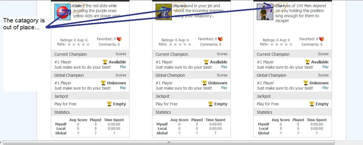

Can you describe how it is buggy in IE?
Excellent.Takes a little time but well worth the effort.As you know you can select high quality leader board games of your choice and create rather a niche mochi catagory.
The image is from IE8 and one member is reporting the same in IE9.
