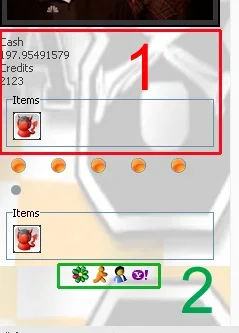

Please see attached exampled image.
Area 1, outlined in RED:
How do I remove and prevent this information from appearing outside of the postbit tabs?
How do I incorporate this information into the postbit tabs?
Notice, some of the information ("Items") already appears in postbit tabs, but is duplicated in the postbit legacy.
Area 2, outlined in GREEN:
I'm assuming you're using our postbit-export.xml or whatever it was to create the default views / tabs.
1. Change the automatic template edit for vBCredits II's Postbit info to dbtech_userinfo_right_after_posts
2. Untick the Item Display Style from vBShop's Item Settings (vBOptions)
3. Remove from postbit_legacy and put in a view:
HTML:
                <div class="imlinks">
                    {vb:raw post.icqicon} {vb:raw post.aimicon} {vb:raw post.msnicon} {vb:raw post.yahooicon} {vb:raw post.skypeicon}
                </div>

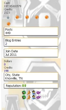

I was left with this, after all changes.
Obviously, I have done something wrong, but not sure as to what.

From the screenshot it looks like you didn't remove the HTML code I showed you from postbit_legacy since it's being duplicated.
