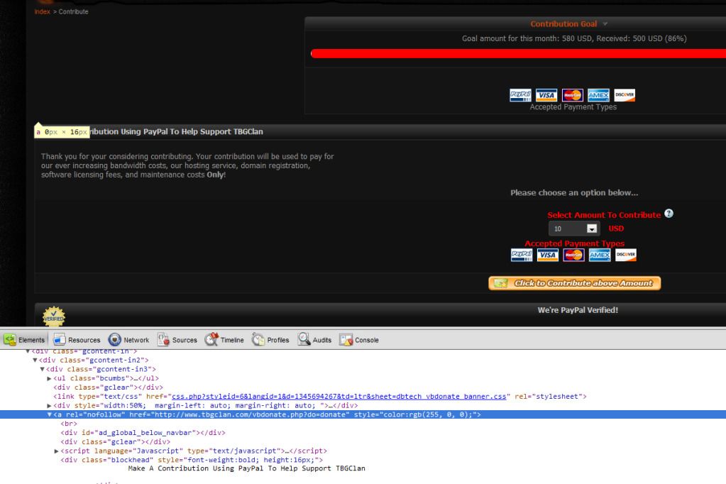

Hey Ozzy I was tracking down an issue introduced in 1.2.1 for us and I have found the fix already but it actually appears to be on your end. When you removed the donate button for vbdonate.php?do=donate as per this persons request https://www.dragonbyte-tech.com/f177/disable-contribute-link-button-8095/. It caused an unterminated link to surround the donation box where you enter your amount and click on the submission button.

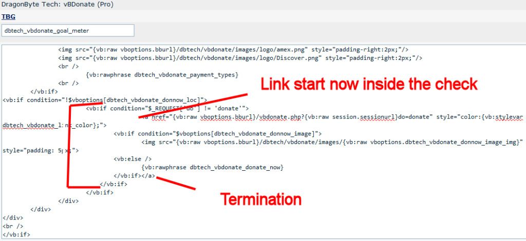

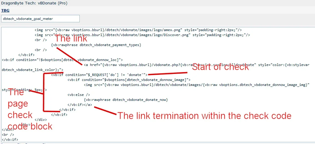

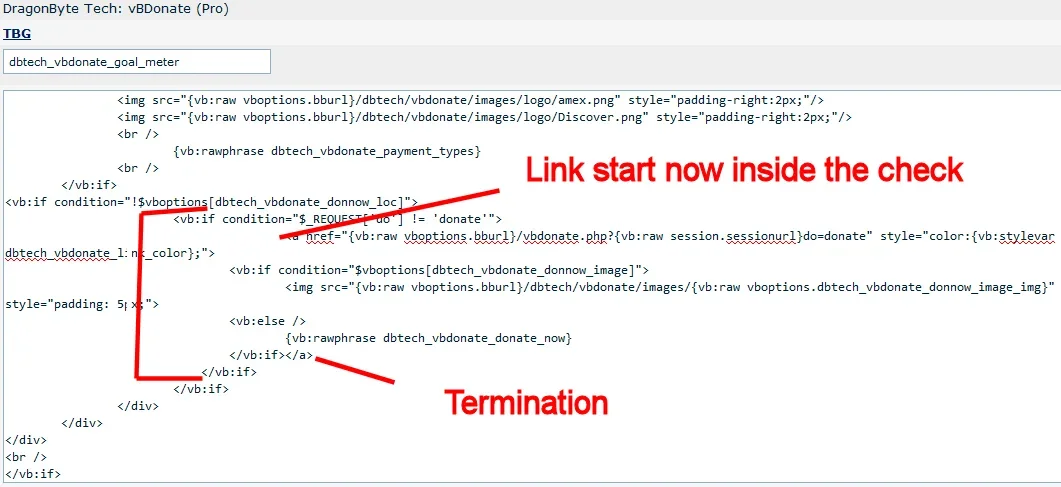

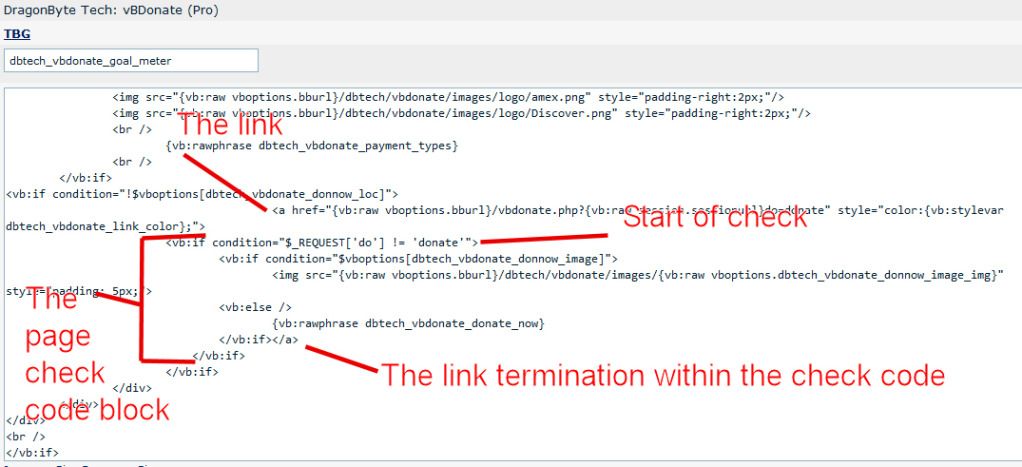

The terminator for that link was in the new code that determines what page the meter is on. But the link itself is outside of the code. So even on the vbdonate.php?do=donate the link is still there in code and until it hits the first termination (/a) all of that became a clickable link to the donation page. Move the link code inside the check for the page fixes the issue. But assuming this is still in the code then I wanted to let you know.
Before: - http://i1104.photobucket.com/albums/h337/RainMotorsports/TBG Forum/goalmeter1.jpg
After: - http://i1104.photobucket.com/albums/h337/RainMotorsports/TBG Forum/goalmeter2.jpg
What originally was showing, an unterminated link causing the whole area to be wrapped in an a tag: - http://i1104.photobucket.com/albums/h337/RainMotorsports/TBG Forum/originalproblem.jpg

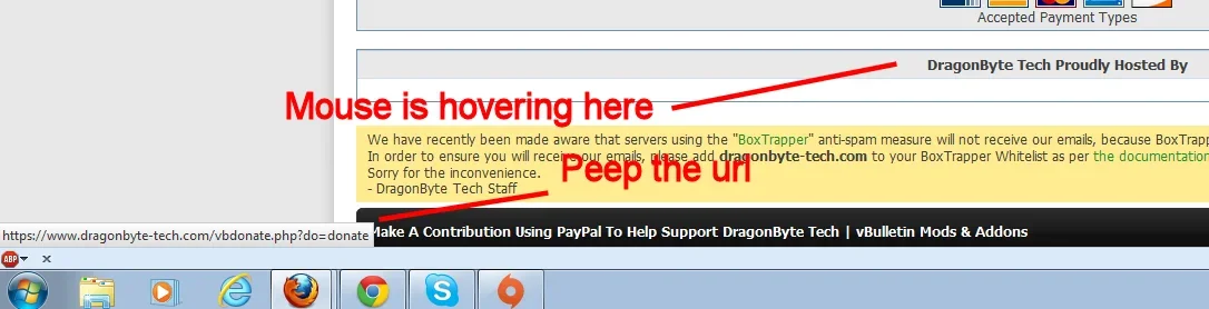

It is actually happening here so I can confirm its not just on TBG!
On https://www.dragonbyte-tech.com/vbdonate.php?do=donate look at the section that says DragonByte Proudly Hosted By. The blockhead or whatever is a link back to the same page. As a result of the unterminated link. Its just much less noticeable here.
Page:
Source:
Much less obvious than it was in our case. I think you will find my change to your code effective here. Since I have found a confirmed case outside of TBG i dont think you will need the test account to test.

In case you saw my reply already I updated the second picture and the text with slightly more accurate info. Anyways the issue is present here on dragonbyte-tech and after you check the fix as per the original post I think you will see whats up.
