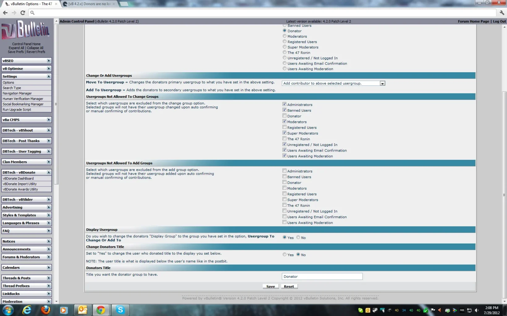

Is there usergroup set in the settings, Usergroups Not Allowed To Change Groups or Usergroups Not Allowed To Add Groups in the Change Usergroup Settings group?
If so remove the group from those settings.
Ok and was the option Usergroups Not Allowed To Add Groups set like that before the person contributed?
