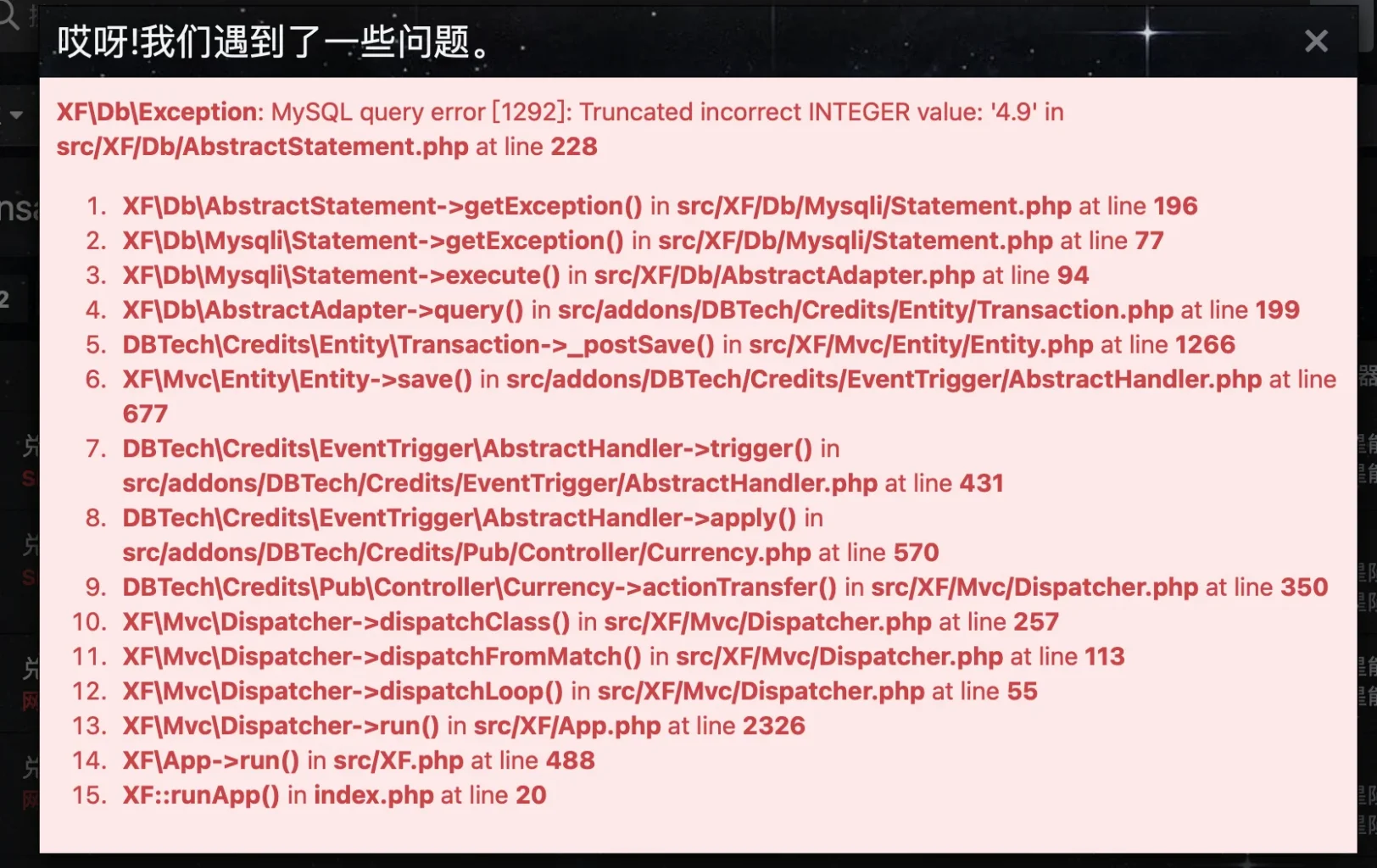

I tried transferring 490 coals to metals but it returns MySQL error.
Is there a way to round the input number to the one fully dividable by the conversion rate?
(e.g. Automatically change the input amount from 490 to 400 in this case.)
This is a server issue. This add-on assumes you have a standard MySQL server setup with . as the decimal separator.
We are using MySQL 8.x as the MySQL server.
I tried googling the solution but can't see anything useful.
Could you please tell me how to change this? or should we consult a MySQL specialist instead?
It would be better if your database administrator looked into this, the database column is a DECIMAL not INTEGER so there's nothing I can do on my end.

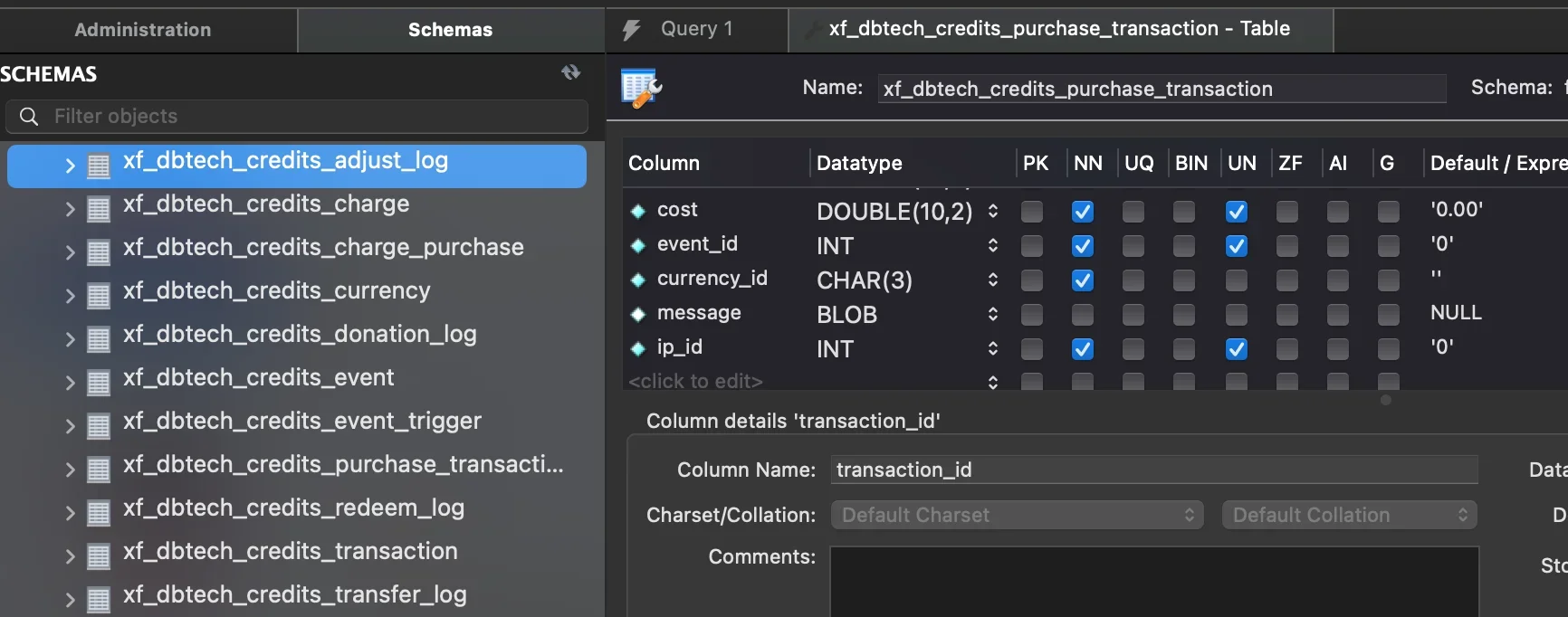

I just checked my MySQLWorkBench and I'm sure that I can fix this as long as you can tell me which database column in which table.
I assume that tt appears to be a problem between UI.X and DB Credits.
(There are UI.X php files mentioned in the error log.)
                    UPDATE xf_user
                    SET dbtech_credits_energy_object = GREATEST(0, CAST(dbtech_credits_energy_object AS SIGNED) + ?)
                    WHERE user_id = ?
#0 src/XF/Db/Mysqli/Statement.php(196): XF\Db\AbstractStatement->getException('MySQL query err...', 1292, '22007')
#1 src/XF/Db/Mysqli/Statement.php(77): XF\Db\Mysqli\Statement->getException('MySQL query err...', 1292, '22007')
#2 src/XF/Db/AbstractAdapter.php(94): XF\Db\Mysqli\Statement->execute()
#3 src/addons/DBTech/Credits/Entity/Transaction.php(199): XF\Db\AbstractAdapter->query('
                    UPDATE xf...', Array)
#4 src/XF/Mvc/Entity/Entity.php(1266): DBTech\Credits\Entity\Transaction->_postSave()
#5 src/addons/DBTech/Credits/EventTrigger/AbstractHandler.php(677): XF\Mvc\Entity\Entity->save(true, false)
#6 src/addons/DBTech/Credits/EventTrigger/AbstractHandler.php(431): DBTech\Credits\EventTrigger\AbstractHandler->trigger(Object(ThemeHouse\UIX\XF\Entity\User), 3, false, Object(ArrayObject))
#7 src/addons/DBTech/Credits/Pub/Controller/Currency.php(570): DBTech\Credits\EventTrigger\AbstractHandler->apply(3, Array, Object(ThemeHouse\UIX\XF\Entity\User))
#8 src/XF/Mvc/Dispatcher.php(350): DBTech\Credits\Pub\Controller\Currency->actionTransfer(Object(XF\Mvc\ParameterBag))
#9 src/XF/Mvc/Dispatcher.php(257): XF\Mvc\Dispatcher->dispatchClass('DBTech\\Credits:...', 'Transfer', Object(XF\Mvc\RouteMatch), Object(DBTech\Credits\Pub\Controller\Currency), NULL)
#10 src/XF/Mvc/Dispatcher.php(113): XF\Mvc\Dispatcher->dispatchFromMatch(Object(XF\Mvc\RouteMatch), Object(DBTech\Credits\Pub\Controller\Currency), NULL)
#11 src/XF/Mvc/Dispatcher.php(55): XF\Mvc\Dispatcher->dispatchLoop(Object(XF\Mvc\RouteMatch))
#12 src/XF/App.php(2326): XF\Mvc\Dispatcher->run()
#13 src/XF.php(488): XF\App->run()
#14 index.php(20): XF::runApp('XF\\Pub\\App')
#15 {main}
I couldn't say, this isn't an issue that myself nor anyone else is able to replicate. Can you check the dbtech_credits_energy_object column on your xf_user table?
