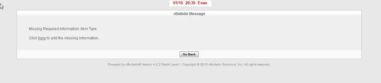

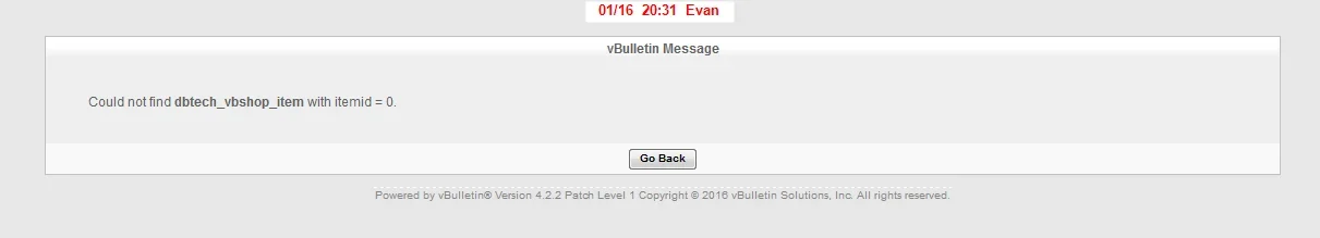

I updated the php variable as requested and still experience the same issue. New items add okay but you cannot edit them (Clicking edit brings you to a "Missing required information, Item Type" and you have the option to click to add the missing information. Clicking that link takes you back to the item management page. Trying to delete the item gives the "Could not find dbtech_vbshop_item with itemid = 0" error.
It's still doing the same thing. I've attached screenshots for review.
